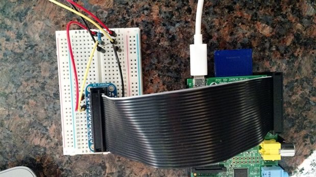

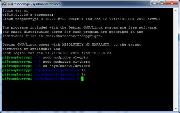

I am really stumped with this, and I am not sure what I am doing wrong.  I am trying to get my DS18B20 waterproof temperature probe to show up in the /sys/bus/w1/devices folder.  I should see the sensor as 28-XXX and w1_master_bus.  I, however, am seeing neither.
I believe that the probe is connected properly.
Any thoughts or advice would be greatly appreciated!

    I'm struggling to see the value of the resistor ...but.
    This might help confirm your connections ...
    https://learn.adafruit.com/adafruits-raspberry-pi-lesson-11-ds18b20-temperature-sensing?view=all

    Thanks Mark.  That is the guide I have been following.  I am checking the connections again.  Its a new error on me.  I don't know why I am seeing an empty folder there.

    I followed this, and it seems to have worked!

    The first problem was in the kernel, and the fix I pointed to got me there.
    The problem with the t=85000 must have been a connection problem.  That is the only thing I could think of.  I tightened everything up and the next morning I saw temperatures being recorded.  Yeah!
