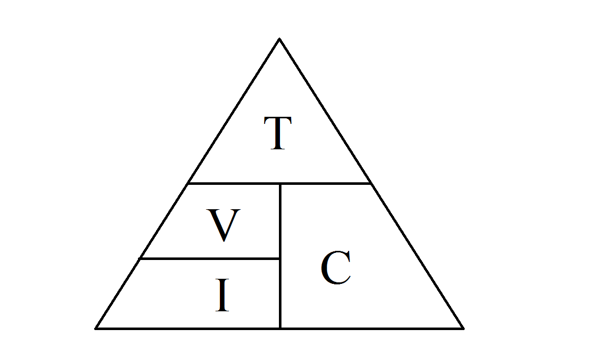

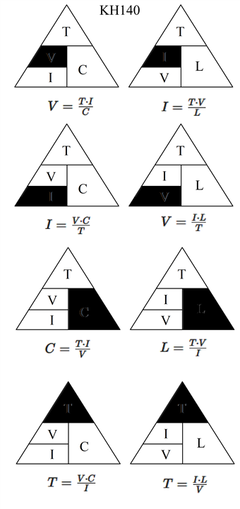

Here is my custom mnemonic math triangle for constant current ramp work. I have this time and date stamped on youtube.
T = Time, V = Voltage, I = Constant Current & C = Capacitance
Enjoy

    I think it's easier to derive from the formula; the arrangement of the four variables in a triangle doesn't work (whereas with three variables, the V=IR triangle makes sense, and same for other relationships…

    How interesting - to me it looks like those meaningless diagrams that people use to illustrate corporate time-wasting presentations Slight smile
    The equation is T = (C * dV)/I
    or dV = (T * I) / C
    (dV because its the change in V while I  and C are constant)
    I just can't see how the diagram shows that.
    If a vertical bar means * and a horizontal bar means / then what does the horizontal bar below T mean ?
    I can't work out a consistent decode of the diagram.
    I know that some people associate colours with numbers or letters (synesthesia) - I don't.
    Maybe "seeing" this diagram is a similar thing.
    MK

    michaelkellett 8 months ago in reply to dougw
    Well Doug, I probably won't forget that .....
    But I think I'll stick with classical maths notation when I need to do sums.
    MK

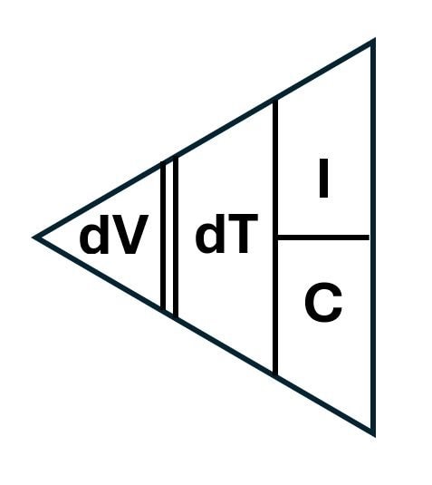

    Here's a four-variable representation which makes sense.. although this was quickly done with AI, so check it before use. The style however is (or was) very popular back when electronic calculators were not common (and often precise values are not needed, just a ballpark, because of component tolerances). This can be done for all manner of formulae (was popular for 555 timer calculations too).
