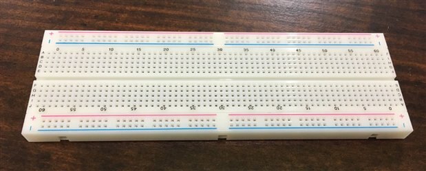

I run workshops to teach STEM basics, sometimes to adults, often to children. Soldering is not always an option, so I've been trying to come up with simple projects to build on a breadboard with fairly inexpensive parts, to show how to make a circuit that does something visually obvious, such as turn on a motor or lights. The groups that organize these workshops frequently have very low budgets to where they couldn't afford enough Arduino or Raspberry Pis or the like for the entire group. I'm frequently given a $50-100 budget for anywhere between 6 and 30 individuals. What fun projects could be built on breadboards that are simple enough for a child to be able to understand? I've found that the best received projects are ones with a result that is the kids can see; a light turns on, a motor spins, etc.
One of the goals of these projects would be reusing the parts for other projects or with another group, so nothing with the project should be destructive.
What simple circuits helped you to learn electronics?

    I highly recommend a few SUPER simple, Super quick exercises just to to stress how the electrons flow and the how the power rails work.
    1) Draw a circular circuit of  Battery > Resistor > LED.
    2) Show them what direction the sockets are connected
    3) Show them the Power Rails
    4) Wire the Battery > Resistor > LED on the breadboard, stressing the flow of the circuit.
    5) Add the complexity of a push button / switch to the diagram and then to the circuit
    I know its super over kill simple, but it took seeing it in that order for me to put aside my apprehension/prejudices about breadboards being "complex and scary" when I first started.

    Looks like  a great board. Though it's totally flat but the design looks new to me. I would like to get more info on this. lol
