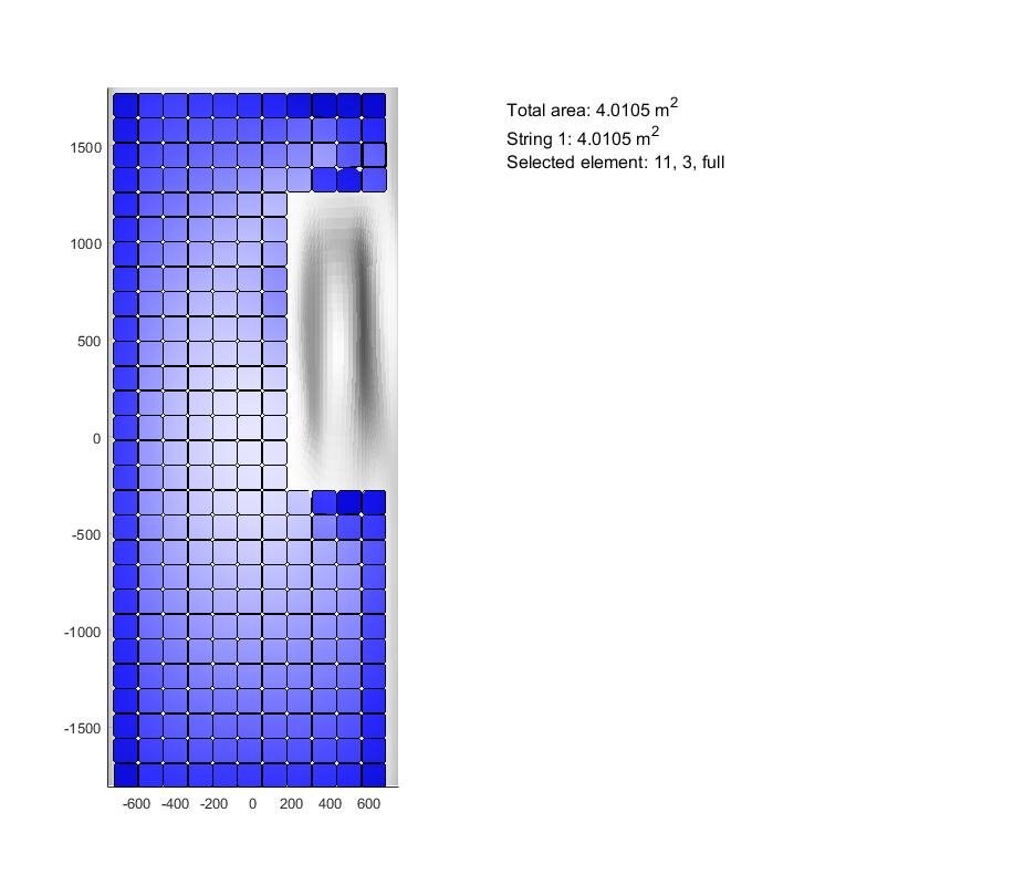

To design a circuit layout that works best under the expected conditions, we developed a specialised software that simulates the expected irradiation distribution on the curved solar panel and the temperature of the solar cells throughout the day. The software also returns the expected power output of the whole solar panel, using the characteristics, the wiring and the position of the used components. By doing so, it is possible for us to test different circuit and weather scenarios to determine the optimal layout for our solar array manufacturer.
