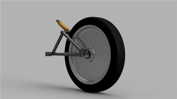

With all these points in mind, we started to sketch some first ideas of our chassis. With the lightweight design in mind, we quickly agreed on a design where all wheels have their individual axle and linkage. This also became essential when we discussed our first ideas with the aerodynamic team which is responsible for the outer carbon fiber shell of our solar car. With the individual axles, they are able enclose the left and right side of the chassis but keep the room in-between free for fewer drag while driving.
The next step was the individual design of the linkages. In modern times of modular systems, we tried to be as modular as possible. This is also due to the production costs automatically associated with prototypes. However, we cannot reach high economies of scale as automotive companies do but we still could lower the manufacturing costs by those means. Thus, we designed the front and rear linkage individually but modular for the respective left and right side. The design of the rear linkage can be seen in the attached picture.
