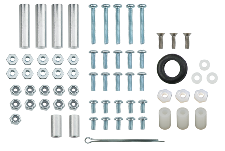

I thought I'd detail some of the changes that I found in my kitset.
There are no revisions or dates on the outer packaging, however the kit of parts inside is labelled 572-28132 Rev D.
Extra hardware.
I found 11 nyloc nuts and nowhere can I see what they were for.
     source      https://en.wikipedia.org/wiki/Nyloc_nut
I still had the required amount of nuts, so these are extras.
There are three countersunk nylon screws, and I know two are used to mount the 4 cell battery holder.
     source       M3X12 NYLON COUNTERSUNK SLOT SCREWS | Premier Farnell CPC UK
What the other one is for is a mystery.
I seem to have an extra nylon washer.
source      M3 Nylon Washers - UNBRANDED - M3 NYLON WASHERS | CPC UK
Two are used for the 'feelers' but I haven't found what the other is for.
I did find this image on the Parallax website, which shows exactly what I got ... including the extra parts
               source       https://www.parallax.com/product/570-35000

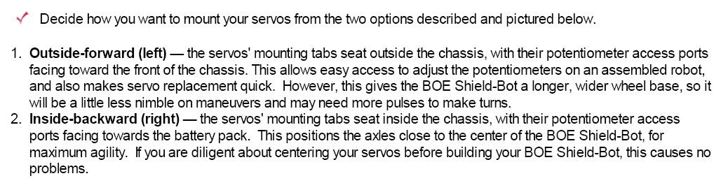

Servo Mounting
The instruction states you need to decide what way to fit the servos
However the image below shows the chassis cutouts for the servo and crucially there is a small notch at both ends of the opening.
I suspect that the previous servos had a single notch and the chassis also had only one notch.
Since these servos have a double notch, you can mount them either way around.
BUT
Because the servo output shaft is approx 20mm closer to one end, the BOE wheelbase will be longer.
The net result is it will have a longer tail, which will tend to add friction on tight turns .....
If you intend to add items to the front and increase the weight forward of the wheels, then rotating the servos so the wheelbase s longer might be an advantage.
I don't like screws and nuts without any retainer, since they will come loose and get lost, so I used 8 of the nyloc nuts for holding the servos onto the chassis.
It is a bit tricky holding the lower ones and you need to do it before the battery holder is fitted.
The advantage is you'll never have to do it again.
