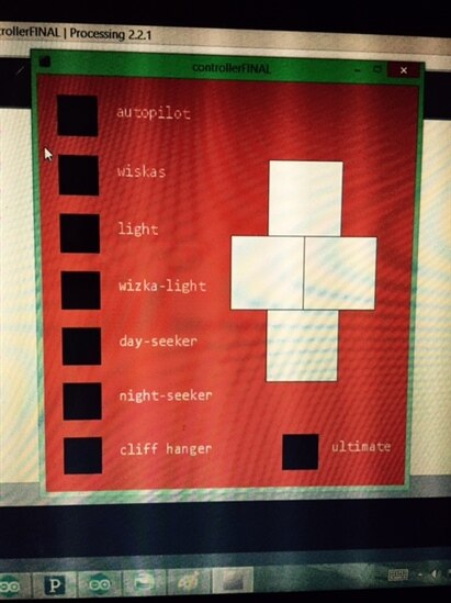

During one of my programming camps I showed a student how to send a letter character through the Arduino IDE serial monitor to control lights and then motors. This was based off of the "physical pixel" example in the Arduino IDE examples tab in "file"--> "examples" --> "communication" path. Student's liked this example however, one student wanted to control the robot with just the arrow keys; specifically by a key press and the one way I know how to do this is by establishing communication between Processing and the Arduino programming languages.
This is the Processing GUI I created to control my robot along with tabs for signaling the beginning of each autonomous function:
The Processing code for this is below. Lines of code 255-257 deal with button presses and how this corresponds with a letter being sent over the serial monitor to an Arduino connected to "COM7" on my machine. This action is indicated by line 34 of the code below:

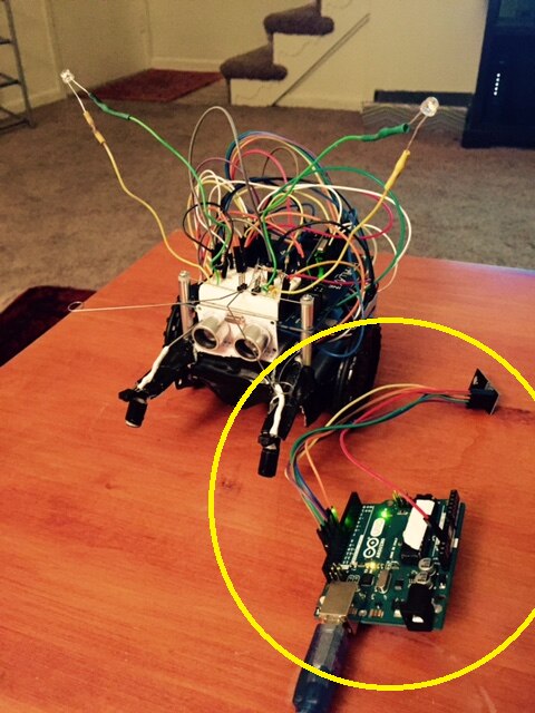

The picture below shows an Arduino connected to "COM7" (circled in yellow).
This Arduino is collecting the serial monitor letter characters being transmitted by an event signaled in Processing.For example, mouse clicks in particular "button region" in Processing corresponds with a value change in the Processing code line 386-455. This is then translated and sent by the "myPort.write(" ") in lines 78-241.
The letter character sent to Arduino (circled in yellow) must then be communicated remotely to the Blambo bot delux robot and to do this it has the following code uploaded onto it to make use of the nRF24LO1 wireless module. The code loaded onto the Arduino is here:

void ULTIMATE(){//combination of all the functions, wiskas, light seeking, obstacle avoidance and edge detection
WISKA();
LIGHTSEEKER();
OBSTICALAVOID();
EDGEDETECT();
Lines 176-190 in the void loop() show how each letter sent to the robot corresponds with a movement function. The entirety of these functions can be seen at the bottom of the void loop(). Many of the sketches which make up these autonomous functions were adapted from the Parallax online code documentation. However, the obstacle avoidance code is something I developed and used during past projects.
The video below is a short, "fun", abbreviated summary of the "Ultimate" function for the Tara Bot Blambo Bot Delux. Bon appetite!image:
