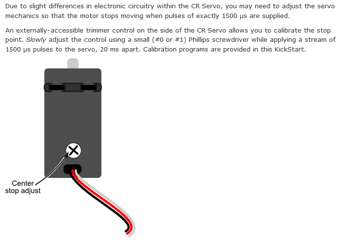

The BOE continuous servos also feature an adjustment for the zero point.
          source Parallax Continuous Rotation Servo | learn.parallax.com

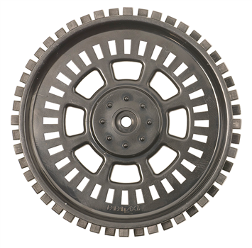

Wheels
By our definition it wouldn't be a 'Robot" if it didn't move, so they have included two wheels.
The pictures above show a different wheel than the ones supplied.
These look like the came off some old metal wheeled tractor, until you realise there is an O-Ring to fit, and the spikes are there to hold it in place.
          source https://www.parallax.com/product/28114
Now we've seen the wheel, the site tells us the diameter is 66mm
A bit of maths will tell us the maximum speed is Speed = (RPM (diameter * PI) / 60)
speed =( 50(66 * 3.141)/60) = 172.75 mm/sec at full speed.
(Just to be sure I went here to verify it Online Conversion - Surface Speed of a Wheel)
There are some other features worth noting.
  • The mounting hole (other side of the images) has splines to fit the servo output shaft.
  • There are 32 encoder slots if you wanted to measure the actual speed of rotation.
  • The O-Ring presents a very small contact patch with the surface, meaning it will lose in a pushing match, but friction should be lower.
  • There is absolutely no give in the 'tyre' so vibrations from the surface will be transmitted to the base plate and components.
If you intend to use these as 'SumoBots' then this wheel combination might be better https://www.parallax.com/product/28109

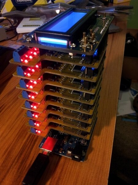

Shield
This sounds like something used for fighting!
You would be correct in thinking that, but in the world of Arduino, a shield is something that fits over the controller board.
They can have motor controller electronics, connectors, sensors, displays, in fact nearly anything you think of has been made into a shield.
Most of the shields have the parts arranged so that they can be stacked.
This is a little extreme, but shows you can stack a few ...
          source Luxcity UV Tonic Control System | mbedded.ninja

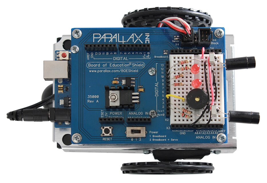

The BOE shield is mounted to the chassis and the Arduino plugs onto it, hanging underneath.
As well as the connections for the servos, and the protyping breadboard, it has a 5v 1A regulator for the power used on the shield.
The battery is 5 x 1.5 = 7.5v and the Arduino can handle anything up to 12v, but to run the servos at 200mA each, you really should have a seperate regulator.
It also has a seperate 3v3 250mA regulator to provide power for accessories.
A reset button (since the one on the Arduino is hidden), an on/off switch for the shield power and some leds.
Very sensibly the Arduino socket layout is duplicated on the top and to the side to allow you to plug extra shields on for other functions.
          source https://www.parallax.com/product/35000
As the photo shows the connectors are well labelled, and its a relatively simple device.
The one thing that appears to be lacking is a power switch to isolate the battery.
The battery power is fed into the Arduino, which then feeds it to the shield using the VIN and Ground pins.
To isolate the battery you need to remove the 2.1mm jack, which hangs out the rear.
