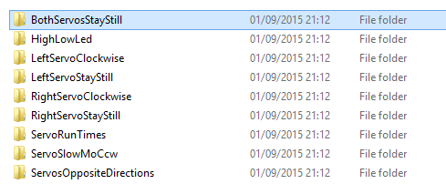

There is a very good set of instructions and code at Robotics with the Board of Education Shield for Arduino | learn.parallax.com.
In order to adjust the servos to stopped, you load  BothServosStayStill from inside the RoboticsBOEShield_Ch2_20120229(1) folder
     photo source 3 minions (me, myself and I)    Adjusting the zero point of the servos.
In my servos they were running slightly, and I inserted the supplied screwdriver and tweaked it until it stopped.
I found it easier to place you finger on the servo shaft and feel when it stopped, and when it started revolving in the other direction.
You simply back it off to get it in the middle of the 'deadband'.  ( https://en.wikipedia.org/wiki/Deadband )
