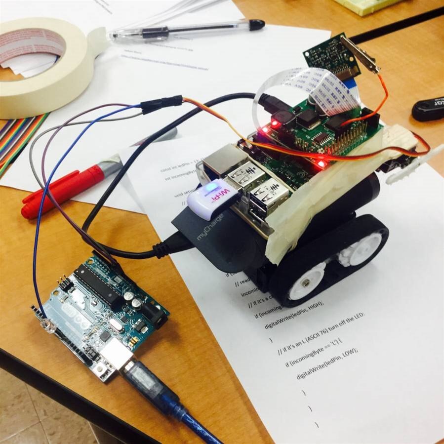

Fair enough, and well done Peter, but there are also simpler ways to do this. Like plugging in the Arduino to the Raspberry Pi using the traditional method of a USB A-B cable:
Connected to the Arduino like so (ignore those lights in the picture):
The USB end plugged into the Raspberry Pi:
There are 4 of those USB ports so you'll still have room for your Wi-fi, USB memory stick or whatever accessories you want to "sprinkle" into the holes of your Raspberry Pi.
Once you've connected the two you are ready to enact Serial communication between a Raspberry Pi and an Arduino: even more interesting, this will occur through combining communication between two different programming languages- Python on the Raspberry Pi and Arduino (C++).

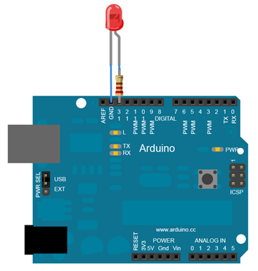

How to introduce these topics to my student though....with so little time and with so much that can be talked about regarding the topic of interfacing and creating a collage of different types of hardware. Well, I decided to start out with giving a demonstration of how the serial monitor on my laptop can be used to communicate with the Arduino to turn an LED on and off. I took the example found within the Arduino IDE called "Physical Pixel" to show this and this saved me time because I didn't have to write anything at all. The set up for the Physical Pixel sketch is as follows:
The code for turning the LED on and off can be found in the drop down example list within the Arduino IDE under the subheading "Communication":
const int ledPin = 13;
int incomingByte;
void setup() {
  Serial.begin(9600);
  pinMode(ledPin, OUTPUT);
void loop() {
  if (Serial.available() > 0) {
    incomingByte = Serial.read();
    if (incomingByte == 'H') {
      digitalWrite(ledPin, HIGH);
    if (incomingByte == 'L') {
      digitalWrite(ledPin, LOW);
In this code, you send the letter character 'H' through the serial monitor to turn the LED on pin 13 on, you send the letter character 'L' through the serial monitor to turn the LED off. Very basic and an interesting point of study to look at to begin the lesson.

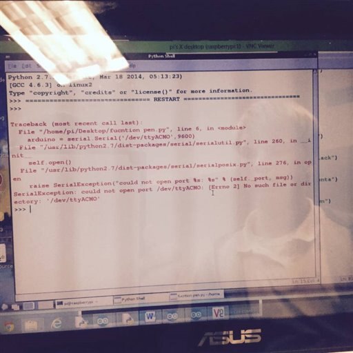

import serial
from Tkinter import *
arduino = serial.Serial('/dev/ttyACM0', 9600)
def ledOn(): # this is how you define functions in Python. ledOn() is executed if onButton is pressed
  arduino.write('h') # sends 'h' to the Arduino
def ledOff(): # this is how you define functions in Python. ledOff() is executed if offButton is pressed
  arduino.write('l') # sends 'l' to the Arduino

Key points to highlight are:
1. This is the sketch that will be loaded into the Raspberry Pi. Notice how there is mention in line 3 of "arduino = serial.Serial('/dev/ttyACMO', 9600)"
/dev/ttyACMO is the name of the serial port when the Arduino is plugged into the Raspberry Pi. This is the same as when the Arduino is plugged into my laptop computer and for example "COM3" comes up as the name for what the serial port between the two is.
2. That we need to "import serial" into the python library to call this function into effect
3. That within the button notice how we have a command= ledOn which is related to the function for "led On" in line 6

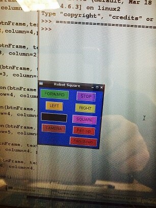

All these things being considered I asked William to adapt this, sketch (which he had written previously, noticing that the buttons he has made earlier also have a command sent upon a mouse click which calls into effect a type of motion for the robot:

appWindow = Tk()
appWindow.wm_title("Robot Square")
appWindow.config(bg = "lawngreen")
controlFrame = Frame(appWindow, width=1000, height = 1000, bg="red2",highlightthickness=2, highlightbackground="#111")
controlFrame.grid() #did not have this last lesson
btnFrame = Frame(controlFrame, width=1000, height = 1000, bg="blue")
btnFrame.grid()
upBtn = Button(btnFrame, text="FORWARD", command=Forward, bg="green")
upBtn.grid(row=2, column=2, padx=5, pady=5)
stopBtn = Button(btnFrame,text="STOP",command=Stop, bg="purple")
stopBtn.grid(row=2,column=4,padx=5,pady=5)
LeftBtn = Button(btnFrame, text="LEFT", command=Left, bg="orange")
LeftBtn.grid(row=3, column=2, padx=5, pady=5)
RightBtn = Button(btnFrame, text="RIGHT", command=Right, bg="yellow")
RightBtn.grid(row=3, column=4, padx=5, pady=5)
ReverseBtn = Button(btnFrame, text="REVERSE", command=Reverse,bg="black")
ReverseBtn.grid(row=4, column=2, padx=5, pady=5)
SquareBtn = Button(btnFrame, text="SQUARE", command=Square, bg="magenta")
SquareBtn.grid(row=4, column=4, padx=5, pady=5)
CameraBtn = Button(btnFrame, text="CAMERA", command=Camera, bg="brown")
CameraBtn.grid(row=5, column=2, padx=5, pady=5)
appWindow.mainloop()

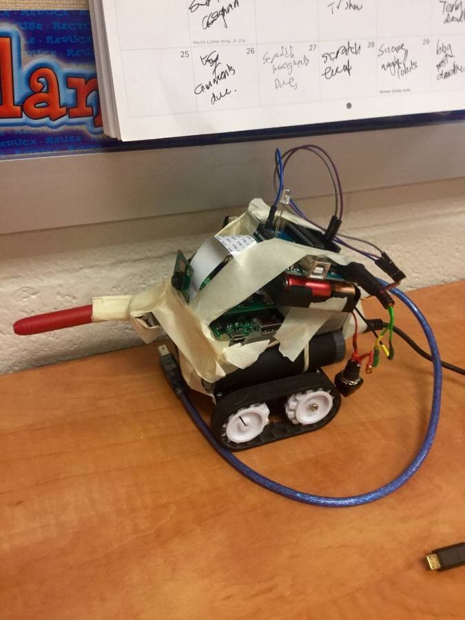

Notice how there are multiple "arduino.write" commands being called into the sketch to write a letter character to the serial monitor. William was able to understand this and write the buttons correctly into his sketch however, he did rush a bit when writting his code so we got this mass of red error messages when we ran the sketch:
This is where the lesson ended. But I monitored his progress and I knew he was on the write track. After William left I spent some time looking at his code and noticed that he had a few errors mainly spelling "arduino" as "arduina" at one point. And also writing the serial port name as /dev/ttyACM0; using the number "0" rather than the letter "O." It's those small things that will get you. Later I emailed William to inform him of where the erros were, making note is his code to show him next time. When everything is cleaned up though this is what executing the Python code produces:
That wonderful control interface, now fresh with a "pen up" and "pen down" function controls this very special robot:
Ah! -The classic red pen and Scotch tape likens this drawing robot to something found out of a crypt from the Valley of the Kings.It was functional though- and provided an excellent; albeit rushed and short introduction to serial communication and the concept of interfacing different types of hardware and software to produce a given function. Please take a look at the following video again to see the end result:
