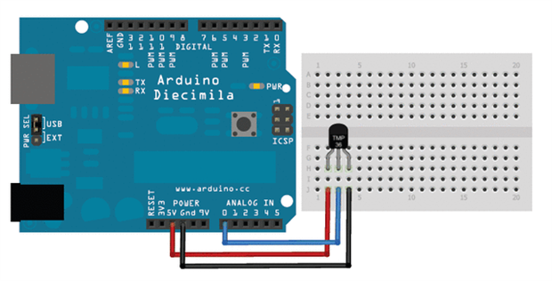

Hi folks! It's been way to long. I didn't give any updates on my Reminder Bot. After planning and practicing for a while, I was able to build rough sketch on how to design the memory of Reminder bot.
As the robot should store and able to reflect the tasks, memory element or a place to store all this inputs is the main I need to get started with. So, After some research, I found MySQL tables in a SQL database would be great to get this job done.  I started with some basics and was able to learn it very soon and my excited drove me very fast to practice that stuff.
In the entire robot kit, I also got temperature sensor (TMP 36), I used it to test my skills on storing responses in an MySQL table. In this blog post I share my initial journey of getting started with this storing responses stuff.
First, I connected the TMP36 sensor as show in the following circuit.
Next, I wrote few lines of Arduino code to read the analog response from this temperature sensor. See the code here.
Then, I wrote a python script which reads the analog response of the sensor from serial monitor and then logs those values into a MySQL table. See the script here.
Finally I was able to store some responses from Arduino into a database, which is going to be a key to build my entire reminder robot.
You can review my code and come forward with some great suggestions.
