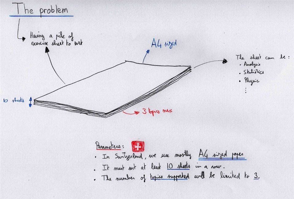

As I like to do when I am searching for ideas I have drawn a few pictures to illustrate what I will do in the next few weeks (months).
After three years studying math physics mathematics mechanics electronics ... (you see the point) I tend to get pile and pile of exercise sheets that I don't want to throw away since they could be handy to have to study
the final exams.
But also those very same sheets are a real pain to get sorted and to keep track of them.
So I thought I could try to build a machine that could sort them out automagically for me... and I would only need to put a little blob of color one one corner to get the job done.
By the way, sorry for my hand-writing. I know that English and American people are not use to this style of writing but it is the only one I know.image

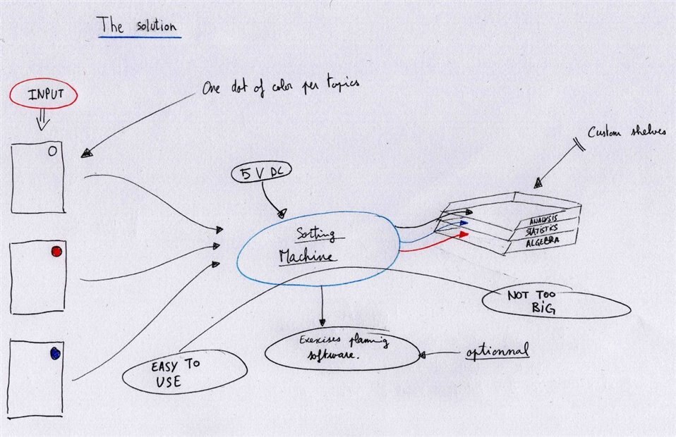

The device should be working just like a printer, but one that doesn't print... It should grab, analyse and class each paper sheet you throw at it image.

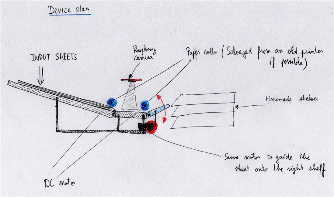

On this drawing, I tried to represent the basic mechanics of the device. It is a really basic design but I will improve it by the time I have to build it.image

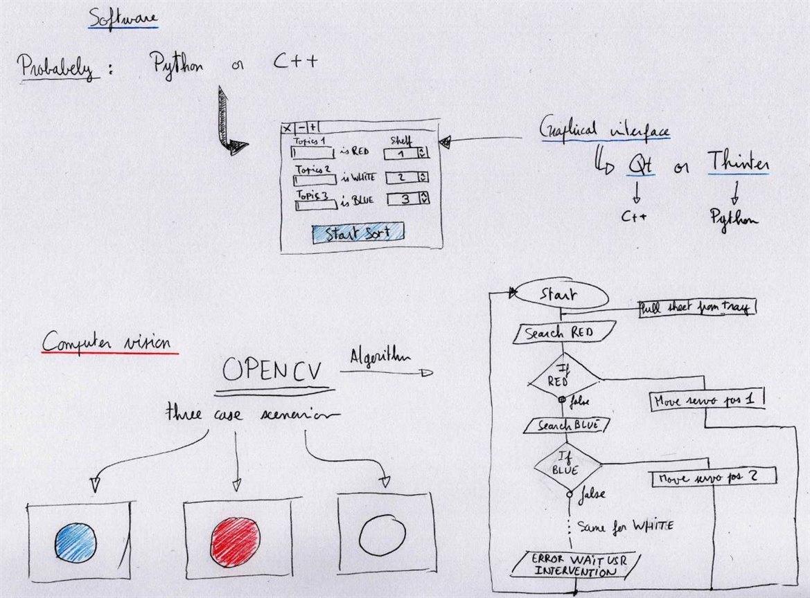

Finally I took a minute to think about the software side of the project.
That is it for now, I will have to wait for the raspberry to be able to move forward with the software. Maybe I will take another look at the mechanics before.

    I was thinking about that, but I think that I will stick to linux to begin with, since I know how to handle the librarys for the GPIO as well as OpenCV. The big drawback of windows on the raspberry is…

    If you can find a small enough printer you might be able to hide the feed mechanism in the device without making it too unsightly.
    Love the idea of using the camera to do the identification, reminds me of the OMR test papers we used to use.

    Yes the feed mechanism on printers is pretty much what I need. But I don't want for my  machine to be build around an old printer (won't look very good maybe image ), I need to find one that could be easily extracted from the printer and adapted to my own use.

    Looks like an interesting project.
    You could maybe get an old printer from somewhere (ebay?) and use that to provide the feed mechanism.

    I hope I will get it to work good enough to be able to "use" it, but I am not sure about the mechanical construction of the machine.
    I haven't found a viable solution to drag only one sheet of paper at a time... I don't really undersand how they do it in commercial printers, maybe I will have to crack one open to take a better look at it.  (If you have any thoughts I would gladly hear them  image  )
