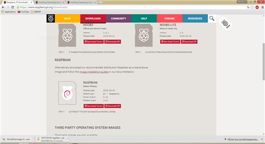

For my first try at using a RPi I did it the easy way ! No crazy things going on here.
I first downloaded a fresh and clean image of raspbian
https://www.raspberrypi.org/downloads/
I am not sure what the NOOB concept is all about but a wasn't too exited about loosing time trying to figure out what this was.
Then whith the little software linked on the page (Win32 Disk Imager download | SourceForge.net)
the process of making a bootable SD card for the raspberry was flawless, nothing to complain about.

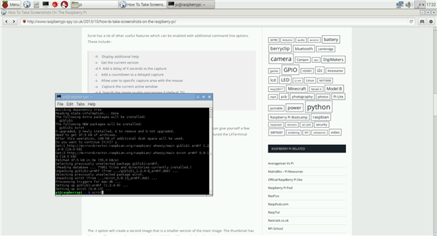

The first thing I needed was a way to take screenshots, so I searched for a few seconds and settled on using the utility package scrot.
sudo apt-get update
sudo apt-get upgrade
sudo apt-get install scrot
scrot
A few lines in the terminal later my first screenshot was here.

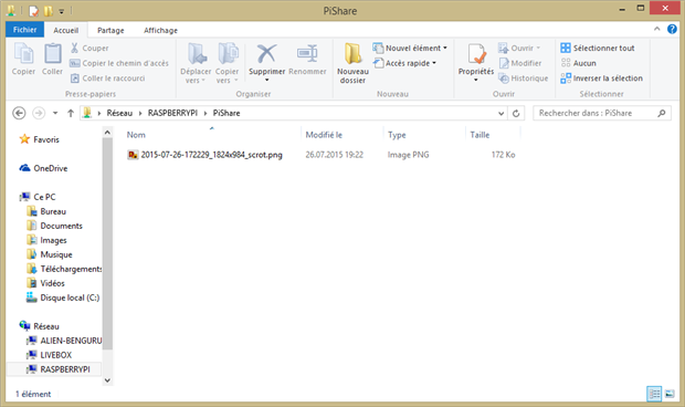

Then I needed a way to easily and quickly transfer screen shots and other files from my RPi to my windows PC (strangely the remote connection works right out of the box with my MacBook).
So I went and followed this nicely done tutorial How-To: Share a folder with a Windows computer from a Raspberry Pi | Raspberry Pi HQ
Having a shared folder on the raspberry will dramatically improve the productivity I will have to develop the project.
