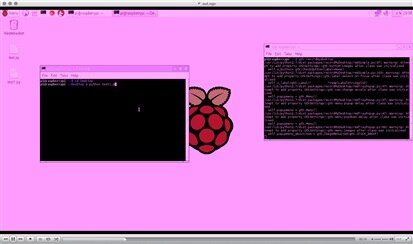

I just needed to record this f****g screen on video, and the raspberry spent literally 1h14 to encode a video that finally turned out to be completely screwed up on the color, it was all red(ish) what a lost of time.
I used the package called recordmydesktop, it has good reviews but didn't quite work out for me.
