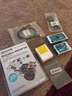

With the educator's road test materials I thought the best place to start would be to setup the Parallax robot shield with an Arduino. There are no instructions which come with the package, instead you need to go the the Parallax website and then the Robot Shield with Arduno learning section which can be found via this link:
Robotics with the Board of Education Shield for Arduino | learn.parallax.com
In the past I had seen the Parallax robot shield online but never considered buying it because I thought it would be too "easy" and not fascinating enough to buy a completed robot rather than build one from scratch. However, when I downloaded the PDF file found on the Parallax robot site (at the link above) I was pleasantly surprised to see that the guide was not only for set up instructions but also a full curriculum of exercises and studies you could run in the classroom. The PDF supporting material allows you to learn not only about robotics and sensors but also the basics of Arduino programming. Furthermore, at the end of each chapter there are exercises a learner can undertake with question and answer sections which could be used as a graded/evaluative component in a class. From the Parallax website you can also get a file of all the Arduino code mentioned throughout the PDF support material which means you can save a bunch of time by not having to retype the examples into the Arduino IDE.
Here is a picture me testing out the function of the robot shield (with the Arduino Uno attached) by getting two LEDs (provided in the kit) to light up:
