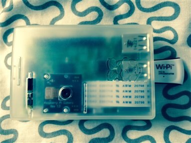

The Kit on Test
The kit for this Road Test is the Raspberry Pi Model B+ Camera Kit in the UK this is branded U:Create and is available from CPC.
The kit comes with a Raspberry Model B+, A Raspberry Pi NoIR Camera board, an 8Gb SD card with NOOBS pre-loaded, a power supply with plug, a Wi-Pi 802.11n Wifi Adapter, a clear case and 36 page user guide.
I will go into more detail about the kit in the review but here I will say that the kit is a really good starter kit. With the pre-loaded OS and user guide it is really simple to get started even if you had not used the Raspberry Pi before. The user guide covers a range of topics from loading the OS through simple Unix commands to some project ideas including physical computing and Minecraft Pi. This is not enough to become an expert but a really good starting point for a beginner with the RPi.
For my planned project I am particularly pleased with the ability to mount the camera securely to the case giving a nice solid platform for photography (no more blue-tack!)

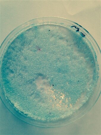

With the Home Educated students (4 - 7yo) I planned to experiment with different crystals to see which would work best for this experiment. After looking around the kitchen and a discussion we decided on sugar and salt for the first attempts. These are thngs that are easily available in most homes so would be best for a Home Education based project.
After spending a large amount time thinking about what colours would be best (we added a small quantity of food colouring to make the experiment look more interesting. I finally solved the colour issue and was able to move on to making a couple of saturated solutions. One of sugar (red) and one with salt (blue). A small sample of each solution was added to a petri dish (a small bowl or saucer would also work). To make a saturated solution it is best if you can hest the liquid whilst you add the solute. In a school we would do this with a beaker on a tripod over a bunsen burner but in the world of Home Education in meant using a saucepan. All you need to do is heat the solution and then add the chosen solute, then stir and heat stir and heat until no more solute will be disolved into the mixture. The better the saturated solution the quicker the crystals will start to form so it is worth taking a bit of time to ensure the solution is properly saturated.
The aim was to test the kit and try different positions for the camera as well as seeing how long the crystals took to form. This would allow us to practice and see how long we would need to run the full timelapse sequence for and to see how best to mount the camera. As the tests were done before the arrival of the kit the camera i had was attached to the side of a monitor using blue tack and the raspberry Pi balanced as best as possible to support this position.
After around 48 hours the crystals had formed and the liquid mostly evaporated from the solution.
The salt crystals were the easiest to see on the Pi Camera and showed a more obvious formation. The sugar crystals did form but was much less visible to the Pi Camera. When we looked closely at the results the sugar had mixed with the colour to make a syrupy solution that did form crystals but they were all stuck together. When I cleaned the dishes afterwards they was still a thin layer of solution under the top layer of crystals which had made the crystals less easy to see.
Out of the two solutes we tried here salt was the best. It does have quite small crystals formed but they were more easily visible. That may have been a little due to the colour choice but overall the salt performance was better. We are looking to see if we can find copper sulphate at our local garden centre to try as well as that would be the solute of choice if I were doing this at school.
As for timings the process was fully complete after 24 hours with all the liquid evaporated from the salt and a solid shell formed over the sugar.
