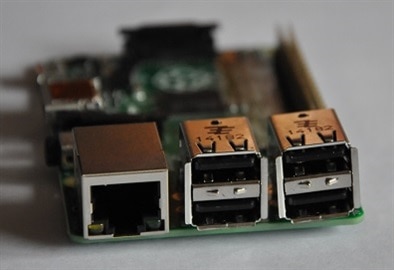

The kit supplied included a Raspberry Pi Model B+ with a case, the PiNoIR camera with the infra-red filter removed to make it sensitive to IR light, a Wi-Pi wireless dongle, a 5 volt 1.8A power supply and the latest NOOBs software on a microSD card. The first issue I had was that the USB ports had not been seated or soldered very well to the Pi PCB and so the openings in the case did not quite line up for the USB sockets.  This can be seen in the photograph to the right.
Installing the camera with its ribbon connector was easy enough and with a bit of easing, I managed to make all four of the ports accessible through the holes in the case in spite of them not lining up perfectly.  I did like the fact that the Raspberry Pi camera can be installed completely inside this case, with the lens looking out through a suitably placed hole. The ribbon cable folds back on itself quite neatly to position the lens through the hole.
