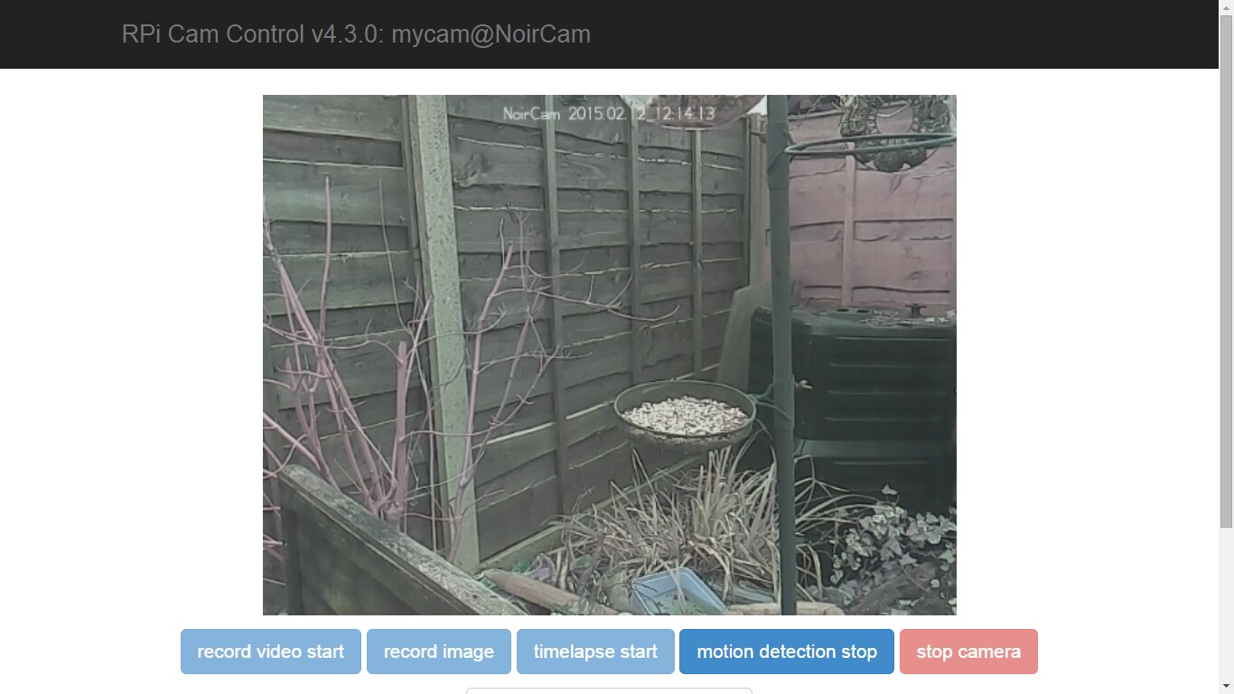

RPi Cam Control is a package which runs on the Raspberry Pi providing an Apache webserver with a browser-based graphical front end to the RaspiCam and Motion video capture software. The RPi Cam Control used in conjunction with the hardware I have described above allowed me to sit in the house and monitor the images from the PiNoIR through a web browser on my laptop. This was ideal because I could keep all the windows and doors shut (it was particularly cold at this period of time!) and still monitor what was happening outside.  The mains cable was running out of the house through my catflap!
Here is the main RPi Cam Control web interface as seen in a browser window. As you can see from the screenshot, there are buttons to start and stop the video capture manually, to take a single still image, to take a sequence of still images in the form of a timelapse, to trigger video capture by detecting motion and to stop the camera completely.  The PiNoIR is some 20 metres away at the bottom of the garden pointed at a bird feeder whilst I am sitting in the warmth of my house viewing the images on my laptop.

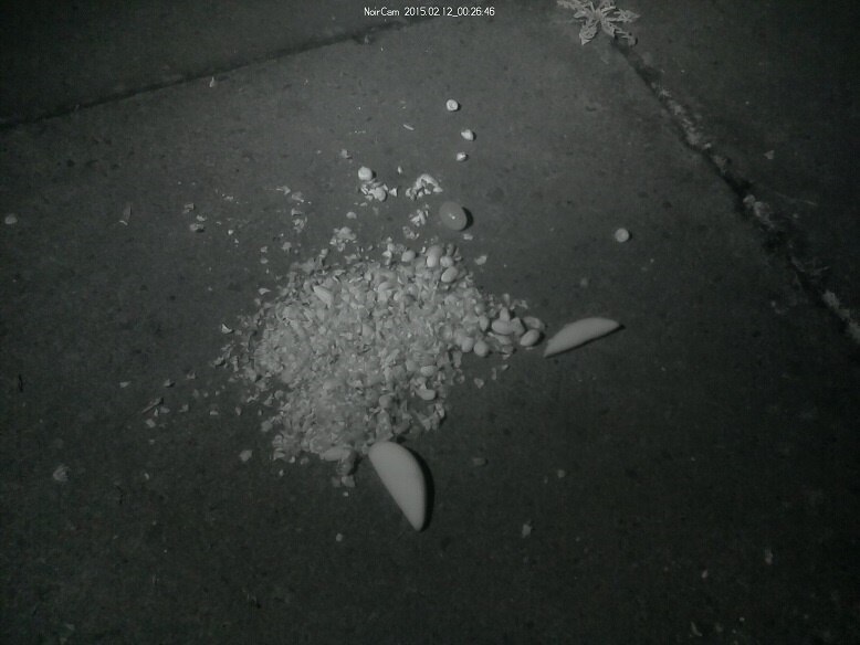

This is the first test image taken in the dark by the PiNoIR under infrared illumination.  It's some peanuts and fruit to attract garden wildlife.
