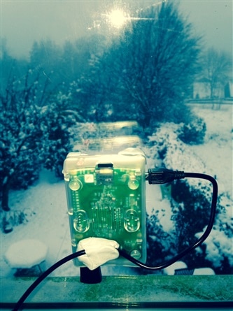

We had a little snow this week so whilst I was experimenting with timelaspe I thought I would try capturing the snow in our garden melting.
I attached the Raspberry Pi and the camera module fixed into the supplied case to my bedroom widow facing the garden.
As you can see there was no space to attach a monitor , keyboard and mouse so i used the Wi-PI 802.11n wifi adapter to connect to the RPi using SSH and VNC.

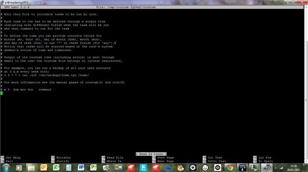

Then I added a cron job using
sudo crontab -e
The last line of the comments show the format of the line you need to add. I wanted to run the file every minute so the line I added was:
* * * * * /home/pi/timelapse.sh 2>&1
If you wanted to change the interval of the pictures you could change the line with the time interval for example for the file to be run every 15 minutes the line would be:
*/15 * * * * /home/pi/timelapse.sh 2>&1
