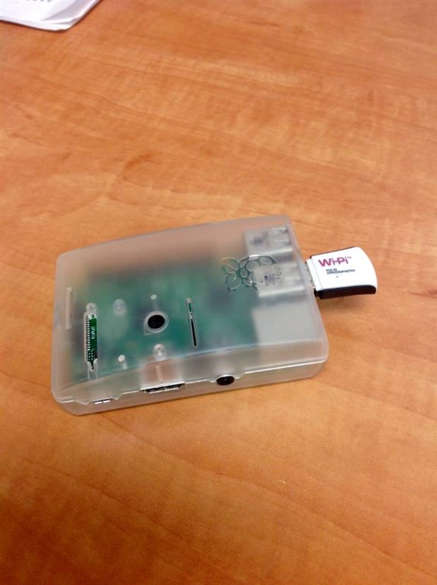

Below are some picture of the basic package Element 14 sent me (note: the camera is not attached):
Wow! A Raspberry Pi B+, a white case, Raspibian pre-loaded onto an 8GB SD card, a  Wifi dongle and a camera board. In general, the basics of what you need to get started with a Raspberry Pi. For those of you who don’t know what Raspibian is, it is the LINUX operating system specific (and recommended) for the Raspberry Pi. And then for those of you who don’t know what LINUX is it is basically another form of Windows, but not made by Microsoft. Instead it’s maintained by a community of individuals who share their programming knowledge with each other in the spirit of collaboration to develop the interface. LINUX is what we define as “open source.”

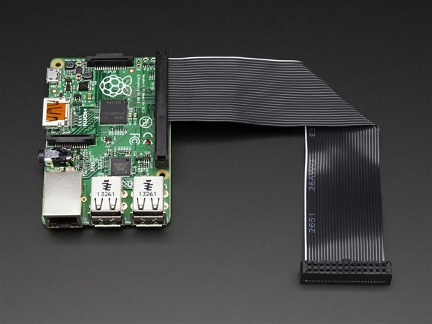

The fireworks for this first lesson was really supposed to be my demonstration of the GPIO (General Purpose Input/Output) pins on the Pi. This is perhaps what causes the Pi to resemble an Arduino micro-controller to some degree and getting little LEDs (Light Emitting Diodes) to flash via Python really gets my blood running. Additionally, showing William how to flash an LED using the Python programming language would be a nice example showing the transition from a graphical computing example (drawing squares) to a physical computing example (lighting up LEDs) with Python. Below is a PI WITH A GPIO RIBBON ATTACHED:
However, this is where I ran into some difficulty. Before the lesson began I had prepared a file on the Pi of Python code I had written or taken online. Some of the stuff related to GPIO and Python were things I had not tried for a couple months. And when I wanted to show the simplicity of lighting up an LED using Python it simply didn’t work. I get getting the error saying something along the lines of: “try running IDLE as root.” But what does this all mean? In the flurry of my lesson I panicked and started Googling all sorts of solutions. I even had poor William type in the commands to redownload the GPIO library through the LX Terminal (excuse my tech Mambo Jambo). Afterwards I found out that whenever you use the Python GPIO library you need to run IDLE in root; this means that you have to type in: sudo idle in the LX terminal. If you don’t run IDLE this way then accessing the GPIO pins will not work and you’ll always get an error. Drat! image

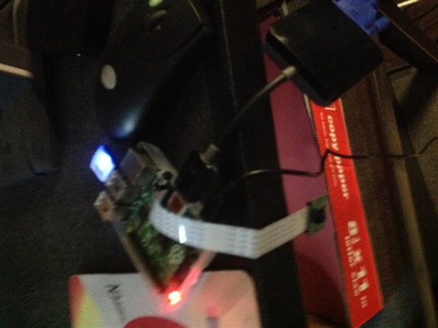

Anyway, William never got to see the Raspberry Pi light up an LED via Python. In fact, the only aspect of physical computing he got to experience was the Pi Camera (what a little gem of electronic wizardry) take a one measly picture set off by a few lines of Python code. In the picture below you can see the Raspi Camera dangling off the side of our computer stand...I apologize in advance for the blurriness:image
What I had hoped to do as part of my lesson sequence was set up the camera board to a push button on a breadboard; thus merging the features of the camera and the LED lighting up. As I mentioned earlier, I never got this far and perhaps I tried to slam too much information into a 40 minute lesson. This is easy to do when you only have one lesson per week with a student. Even though things didn’t unfold according to plan I asked William what he thought of the Raspberry Pi and he said he thought it was “pretty cool.”
