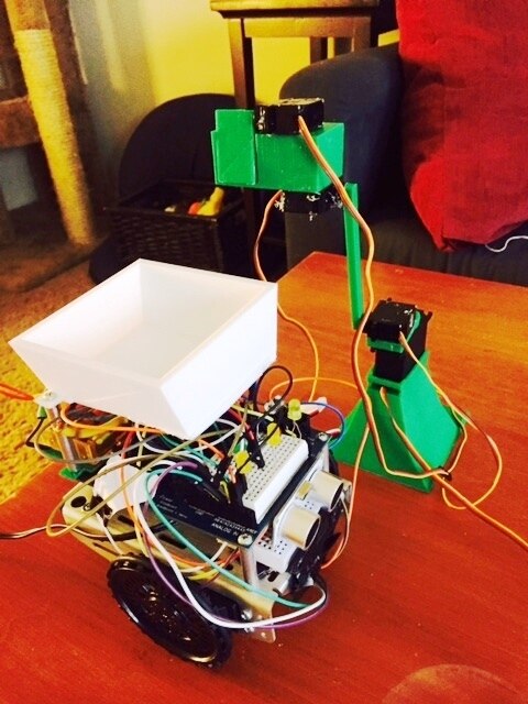

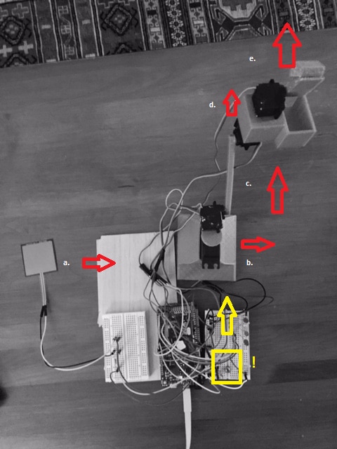

This robotic arm/line following robot is the conclusion to my summer project for the "Teacher's pet- educators road test." Believe me, this effort to create something original with a Parallax Robot and MATLAB/SIMULINK came a long way from where I first started.
In all, my robotic arm is made up of 4 servo motors controlled by an Arduino Due; but the improvement from my last blog post is that the arm starts according to two options:
1. A remote button push (labeled "!" in the photo)
2.  Pressure on a force resistance sensor which is"wired" into the movement of a robot (labeled a. in the photo)
I'll choose number two....and set off an autonomous, industrial process which dispenses rice krispeis.....
My device can be described in parts: the base, arm, hand, finger.
The relation between these part's timing is how the robotic arm achieves a grabbing motion towards rice krispies.
In fact, each part of the arm is timed differently going downwards to pick up the rice krispies than the sequence back up in order to stay out of the path of a moving, line following robot. The timing idea is represented by the photo (above/right)  where "!" is a button press which causes the arm to dance through motion "b", "c", "d"."e" when moving down and then during the inverse directional movement going up, the pattern of movements then follows "d","c","b","e." Pressure on the force resistance sensor "a" causes the same chain of events as during the button press.

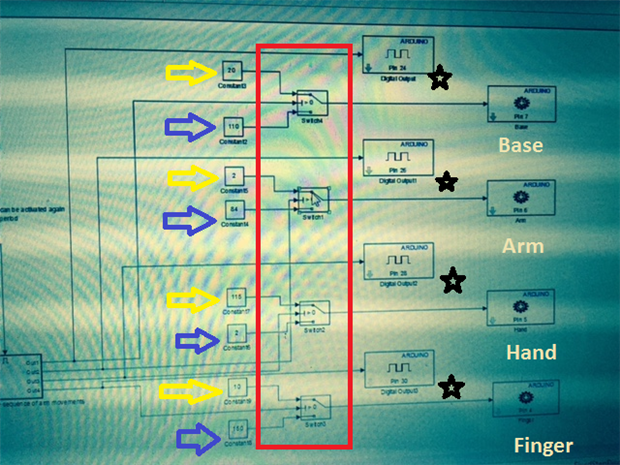

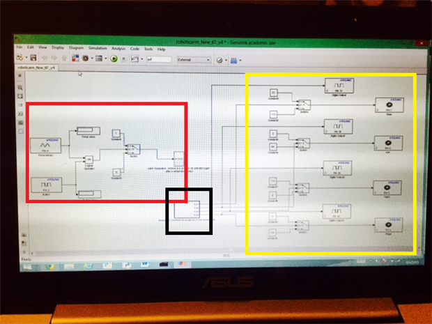

The colored boxes I drew in the photos below is my way of representing information in rectangles. What I have learned during the Teacher's Pet challenge is that this is exactly what MATLAB/SImulink in trying to do albeit, without any color. Below are images of the Simulink model loaded onto the Arduino Due controlling my robotic arm:
If you have MATLAB/SIMULINK, you can download the completed model HERE
The model can be defined in 3 regions which flow from red-->black-->yellow.
Up close, the red block looks like the photo above; the force resistance sensor and button are in their respective boxes for Arduino pins (Pin 0 and Pin 2). A signal caused by these starting blocks pushes a value of 1 or 0 value through a "latch subsystem"; which is basically turning the robot on and then starting a running clock for when the robot can be started again:

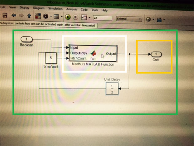

If you click into the "latch subsystem" the above photo is what you'd see. Inside the white box is a MATLAB function which Madhu from MATLAB/Mathworks helped me develop. I've never used MATLAB/SIMULINK before this road test so Madhu's understanding of how MATLAB code can be stored inside function blocks in Simulink was appreciated. It was also helpful to have someone tell me where certain Simulink blocks like "delays" are located because there are a lot programming blocks to consider inside the IDE.
Timage
When you click into the Madhu's MATLAB function, lines of code (above photo) count incremental gains of 0.25 sec. until a "latch" limit (in my case, which is set to 5 and exists outside the function block, in the photo a couple above as "time/wait") is reached. In this way, the code works like an upward counting egg timer which signals when your eggs are hard boiled and then when another egg can be plopped into the pot. Here is that code again in a format you can copy and paste into MATLAB:

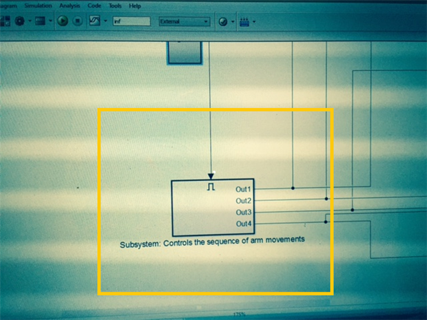

When the timer is in progress another subsystem runs......

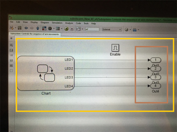

....double click the rectangle in the yellow box and this is what you'd see:

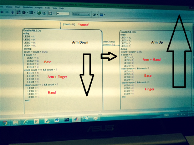

Inside is a chart block which contains a list of 4 LED lights being turned off in a pattern set to move along with the robotic arm's motion. Note: remember when I discussed "the movements of "b", "c", "d"."e" when moving down and then the inverse movement going up as "d","c","b","e.""  hint, hint......
And yes, of course! The "on" and "off" of the LED lights corresponds to the movement up and down of a respective servo motor. In fact, I figured out that the timing of the servo motors by first controlling the timing of flashing LEDs.
Each servo on the arm can be in two possible positions, the angles of which are recorded in constant blocks in Simulink (see the photo above). The yellow and blue arrows are pairs of angles for each servo mirroring the "on" and "off" function of the LED lights; yellow is for the servo angle moving up (LED OFF) and then the blue for the servo angle moving downwards (LED ON).

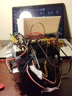

Inside The TaraBOTBlamboBotDELUX version "Line Follower to the Extreme" robot:
This line follower to the extreme was programmed in Arduino's development environment.
The ultrasonic sensor on the front of the robot is used with a line following routine. If you put your hand in front of the robot it will stop and if the hand is there to long then the TaraBotBLAMBObotDELUX (Line Follower to the Extreme version) reverses direction and continues to hug the line.
Unfortunately, Madhu and I never could get the Radio shack brand ultrasonic sensor I have to work in a Simulink models, therefore highlighting a limitation, convenience wise, when programming Arduinos with Simulink as opposed to the traditional Arduino IDE. Nonetheless,here is the final version of the code for my line following robot, Arduino style:

You may have already noticed that my line following robot has a white bowl to collect precious pieces of rice krispies as they fall from the sky. This bowl, like the robotic arm, was 3D printed on a Printerbot Makers edition which in itself is a miracle with models coming unstuck from the printing bed so often.
