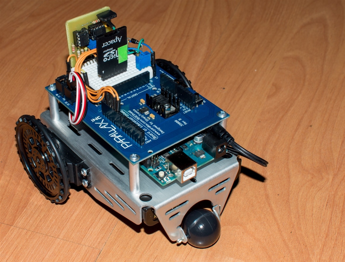

I finally have some free time, and today I bring to your attention a new article! This time, I'll tell you about the hardware of my robot.
The project includes the following electronic components:
  • Parallax continuous rotation servo (2 pcs).
  • Parallax robotics shield kit (1 pcs).
  • Arduino Uno (1 pcs).
  • Sound card (from previous articles, 1 pcs).
  • AA batteries (5 pcs).
  • Micro SD card slot (for the next stage, 1pcs)
To date the robot is fully assembled, but if necessary it will not be difficult to modify a bit its construction, in particular using microSD card slot and replacing Arduino Uno by Arduino Due. However, the initial idea of the project may be realized just now.
As for melody playback, it works, of course:
Also, I tried the robot in motion. To do this, I wrote a simple program that makes the robot move in a random route:
The program of his movement as a whole is very simple and everyone can try it on his robot:
