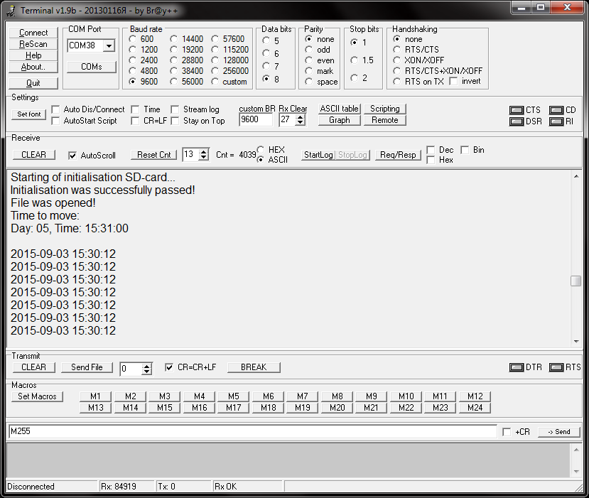

Good day comrades!
Today I want to present to you the final article of the series. As you probably remember, the last time I discovered a critical flaw in my Arduino Due - the DAC broke down. It is sad of course, but is that a reason to stop? Of course not! After all, I promised my readers to install RTC on the robot, and we are going to do it today.
However, before we proceed, we must mention one more thing: the fact is that in my [voting] an item on Matlab  has won a lot of votes. In addition, Madhu Govindarajan personally asked me to devote to this issue a little more time. Well, I could not refuse.
Now, first things first.
1. A few days ago I got RTC DS1302, that I had ordered on ebay about a month ago. I tested them at the bench on which the Arduino Duemilanove was installed and found one problem: if I connect to the RTC the battery of autonomous power (well known CR2032 supplying 3.0v), the clock can only work at Vcc = 5.0v, while without this batteries it works successfully at 5.0v and at 3.3v as well. This is quite a serious problem, because the Arduino Due is powered by 3.3v. However, as it turned out, the chip line CLK, IO and RST perceive the control signal as a logical "1", if the voltage is greater than (Vcc - 2.0v), so I still managed to connect the chip to the robot:
2. As you can see, I took off robot's audio system, because with my existing Arduino Due playing music isn't still possible ...
3. Thus, the robot is assembled. What's next? Then, of course firmware! The algorithm of work of my program is as follows:
  • read the first line of the config.txt file from SD-Card;
  • determine at what time and day of the week the robot is to leave the "garage";
  • determine what melody (or message), it must play at the same time;
  • upon the occurrence of specified time a robot leaves the garage and plays a melody / message, and then (if necessary) some time later comes back and reads the second line of the file config.txt;
  • the cycle is repeated as long as the config.txt file runs out of records.
4. Why all this? The answer is simple! I conduct classes 3 times a week (hereinafter provided "examples of lessons", really there are many more):
  • Monday, 14:00 informatics;
  • Tuesday, 10:20, programming;
  • Thursday, 19:10, industrial automation.
Each session lasts 1:30, so the robot must:
  • On Monday at 15:30 go out and announce the homework on informatics;
  • On Tuesday at 11:50 go and announce the homework on programming;
  • On Thursday at 17:00 go out and announce the homework on industrial automation.
This behavior of the robot will help me not to forget to stop in time (because I really like to linger!) and certainly amuse my students and get them to come to class next week (I hope).
The configuration file for the robot will be as follows:
15 30 00 2 informa.wav
11 50 00 3 program.wav
17 00 00 5 industr.wav
5. The configuration file seems to be simple, but why not to automate its generation? And to help us with it comes again Matlab!
6. I wrote a small program with a remarkable module called GUIDE. With it, I quickly created the program interface:
And then proceeded to write the code. As you know, the help system of Matlab - is the best in the world (at least all my friends-teachers think so) I did not have any problems.

If you wish, you can download the source code from my file archive: [program]
7. So, let's see how it all works. First, let's create a configuration file:
Now let's see how the robot responds to the attainment of a timestamp. As always, not without a small incident: I set the time on the robot according to my  wristwatches, which turned out to be ahead of the "normal" time by 12 seconds:
If you're interested, here's Log recorded from the robot during tests:
