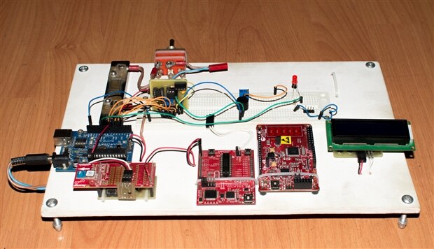

Now, when it became clear why I made my own analog sound card, let's see how to work with it. Let's start with the simplest example - an electronic piano. By the way!
You know it? Yes Yes! It's my good old stand, known to readers of my series of articles about tricopter.
So, the idea is this: connecting some contacts of sound cards with GND we achieve playing back a note. Since the last time I‘ve improved the circuit and now I‘ve managed to avoid stray harmonics 3.3 kHz (if you're interested - I can write about this in the next article). To play sound I use Arduino Duemilanove, digital lines which are connected to the inputs of the sound card, it uses the following program:

    I like the nice secure way your keeping the hardware laid out. Easy to wire up and easy to demo I'm following the project, interested to see where it leads
