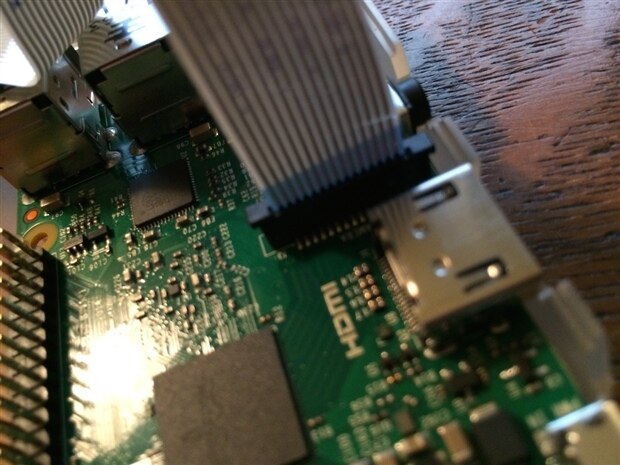

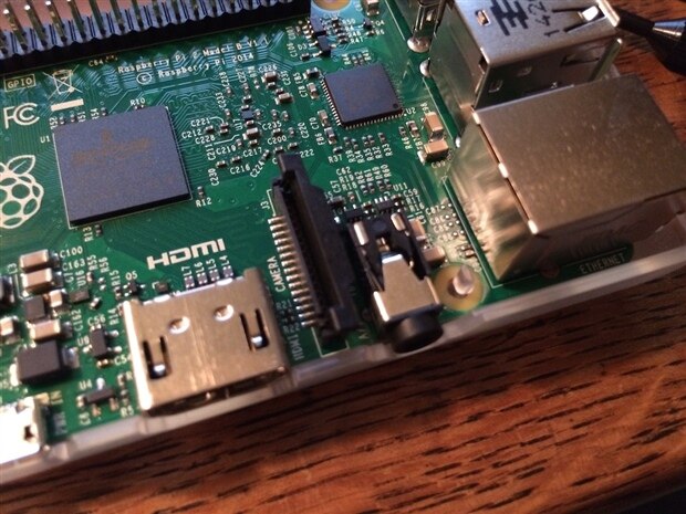

The first step here was to install the camera board itself.  The board ribbon will gone into the Raspberry Pi’s “CSI Port.”
There. It’s inserted into the CSI Port.

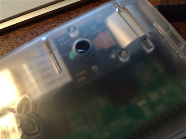

And now it’s been gently doubled over to fit within the Raspberry Pi Project Kit Case.
Yes, I’ve left the lens cover on because I am very afraid of damaging it just yet.

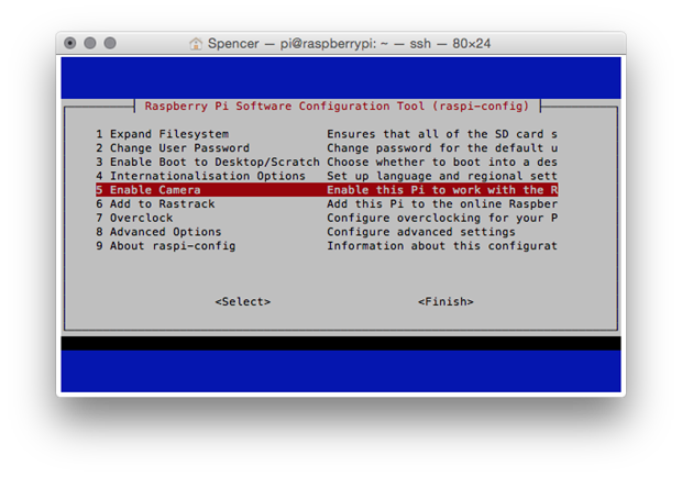

Referring again to RaspberryPi.org, let’s follow these directions for connecting the camera in software (https://www.raspberrypi.org/documentation/usage/camera/README.md).
Here, from Terminal, I am able to access the ‘rasps-config’ command to enable the camera.  [Notice how this screen exists in Terminal, but the GUI "x" does not. Type 'startx' and get an error.]

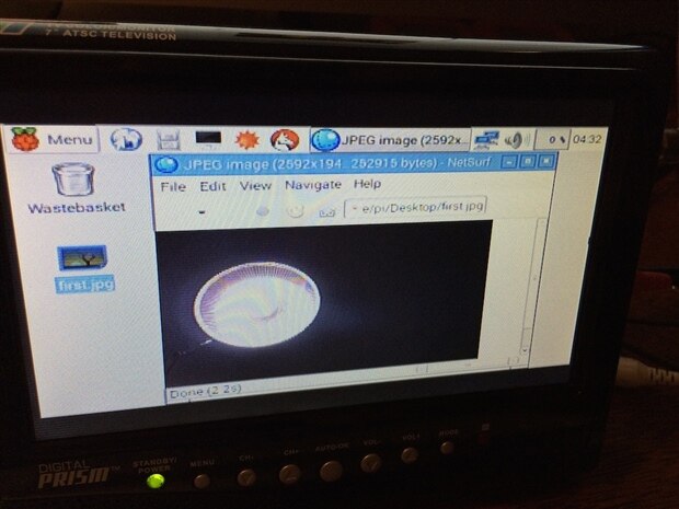

Here’s the first photo taken with ‘raspistill’!
And there we go!  A beautiful angle on my desk lamp.  In full inferior color!
That, according to documentation, is a 5MP picture being viewed in the Raspberry Pi’s web browser with extreme zoom, on a 7” screen.  Marvelous.
