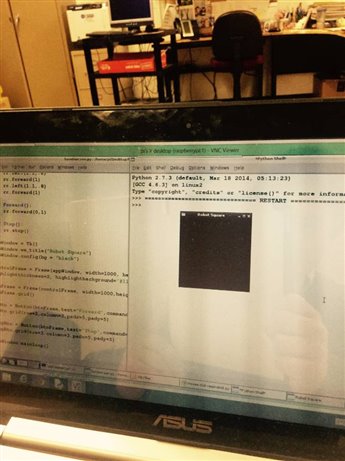

1. Create a control interface for the Raspberry Pi "Turtle Bot". During the last class William and I had issues working with the Tkinter library as a result of missteps following the worksheet I created for the class. Essential commands were left out of our Python code using the Tkinter library that instead of seeing a glimmering arrangement of buttons to push to control the directional movement of our robot all that was seen was a giant black square:
Goal 1 Completed: I was so happy with how William got right down to business. I explained what the issue was with our Python code last week and he quickly hammered out the following script:

What may have helped is that I was not looking over his shoulder the whole time while he wrote this stuff. Instead, I gave him time to read the worksheets and then trouble shoot the code himself. He would then show me the finished/functional product (which was in about 20 minutes):

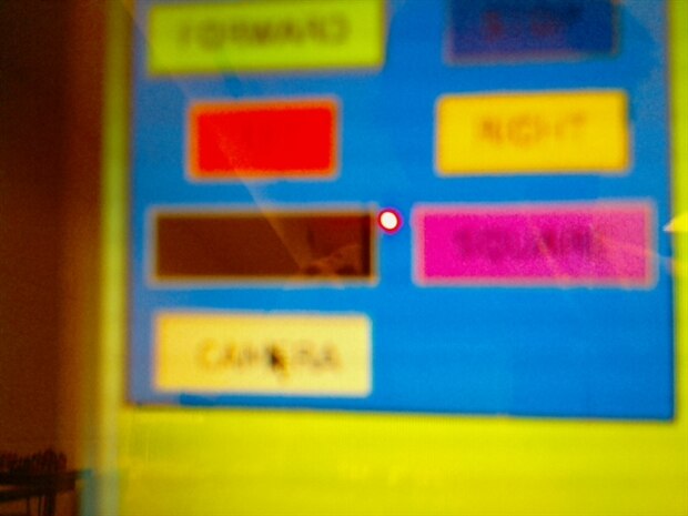

When the camera is not moving this is the sharp quality image it can capture. However, when the camera is jiggling around the top of a wire on the Turtle Bot these are the kinds of images you get....not the best photos of the screen with buttons but the point was to use the button "CAMERA" in William's code to take the photo:
Goal 3 completed:
Like I said...not the nicest photos but when the camera is still it takes very nice photos. Wllliam took a selfie which turned out very well which I then sent to him via email as a memento of the lesson.
