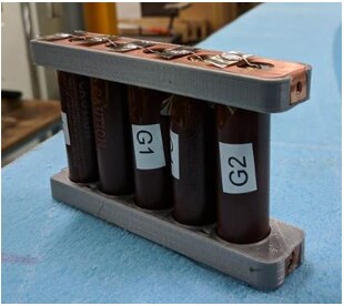

As such, this year we have had a strong focus on the modularity of our design. Each parallel branch of our battery is its own self-contained module, composed of two 3D printed blocks which each have their own copper busbar and individual fuses for each cell. These 15A fuses were soldered onto two squares of nickel strip, one of which was spot welded to one side of the cell and the other was spot welded onto the copper busbar. The spot welding was largely done with help from Dukosi, one of our sponsors, who offered their facilities and expertise during the fabrication process. However, with the welds being so brittle, several did not survive very long, meaning we had to redo some of the welds in-house.
Spot welding at Dukosi
                                            Our battery module

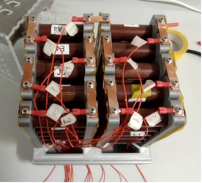

The copper busbars are folded round to the shorter side of the module as shown above, and extra busbars are screwed on to make the connections between modules. This has been done in such a way that means that when the battery is assembled, all cross-module busbar connections and BMS wiring is contained to the upper face of the battery, making the battery a lot tidier and easier to work with.
Assembled battery with BMS wiring

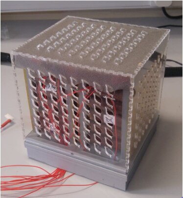

In terms of the case design, we have opted for an inverted case idea using plexiglass and 3D printed plastic, with the plexiglass lid forming the top and all four sides and the 3D printed part  being only the bottom of the case. This, combined with the fact that all wiring is contained to the top face of the battery, means that work can be carried out on the battery without even removing it from its case. This case design also features a compartment underneath which neatly houses our BMS and a Raspberry Pi Zero for battery monitoring.
The plexiglass cover has been laser cut with a grid of leaf-shaped holes, which will help promote airflow once our cooling fans are attached. The plexiglass pieces have been assembled using acrylic weld cement. Our full battery and case is pictured below.
Battery and casing
If anyone has made anything similar we would love to hear from you! We also appreciate any comments or questions on our design.
