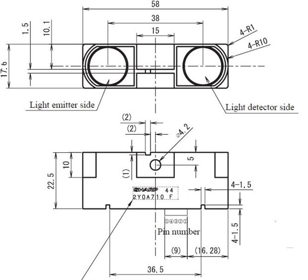

The sharp IR distance sensor GP2Y0A710K, has a good detection range from 100 cm to 550 cm with a decreasing exponential response with increasing distance. There are 5 pins on the sensor to be connected. These are 2 x supply voltage,2 x gnd and an output analog pin. The pin configuration is shown below.
The pin 4 of distance sensor is connected to the pin 1 Channel 0 of ADC MCP3008.

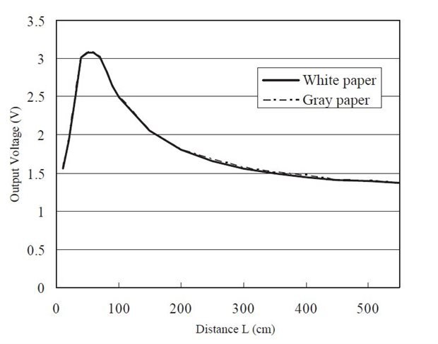

The distance sensor GP2Y0A710K, has a detection range from 100 cm to 550 cm and considering the analog output values of the sensor at the extreme distance values of 100 cm and 550 cm, we have,
Distance (m)Analog Voltage (v)Digital value (0 to 2^10-1)
                                      1                                          2.5                                512
                                    5.5                                          1.4                                286
and we can thus put down an equation for approximating the analog output into distance.
We have a linear equation of digital value and distance.
(512-digValue)/(1/100-1/distance)=(512-286)/(0.01-0.002)
=> distance=28250/(digValue-229.5);
Here,
digvalue= voltage * (1023/5)>>> It indicates converting 0-5 V to 0-1023 i.e. a 10 bit resolution.
Hence, the appropriate formula is given by,
Distance=28250÷(DigValue−229.5) centimeters.
But, you might be wondering about the contradiction that there is an another formula mentioned in the previous post for distance calculation. Yes, that is also a valid formula but, it is calculated by considering entire range of distances irrespective of the working range of 1-5.5 m. Hence, you might find that the one mentioned in the previous post is a bit erroneous compared to the present one.

    Great job on the post, Is there a specific reason why you did not consider this a piece-wise linear function and chose Linear through out? Will be great to see your progress :-)

    Yep I agree, the difference should be minimal and hope your application is not sensitive to those errors.

    Good question.......I first though of applying it for ranges of 100cm each....i.e. like 1 formula for 100-200...1 for 200-300 and so on.....but when I saw the results.....it was more or less approximate and the main point to notice over here is that for my application I will be using like 100-150 or 200 cm range only, which is pretty much a straight line.....so I was satisfied with this outcome...if at all I feel that there is more deviation compared to actual, I will change it by calculating it from 100-150 cm for increased accuracy.
    There could have been another solution to your question.....which is to form an equation of that parabolic part, which according to me is time consuming and I feel to adopt simple strategy when you have other options.....
    In my next post, I will be uploading my program, which performs the measurement of the distance and averages it to get the most agreeing values.
