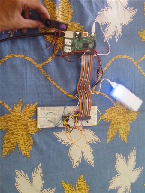

In the last blog post we have learnt about SPI communication, how to take analog readings with Raspberry Pi with MCP3008 ADC and we have derived a formula to convert the voltage readings to distance values from the Sharp IR distance sensor. Please refer to the previous blog post in order to get a clear understanding on what is explained in this post.

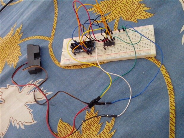

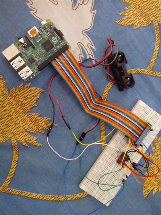

Just connect the distance sensor and ADC as directed in the previous blog apart from connecting Ethernet cable between raspi and computer, and powering it, before trying to burn the code to raspi through matlab.

The above pic shows the working model of the distance sensor being monitored by raspi and we can see that the IR transmitter being lit up which distinguishes it from the receiver module beside it.
