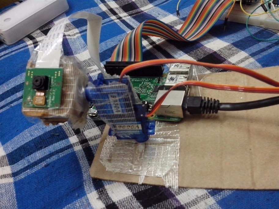

You will need two servo....preferably micro servos as torque requirement is very less and you can directly power it from micro controller board like arduino. I choose arduino to control it instead of using Raspberry Pi because Pi just has provision for attaching one PWM pin. However, we have two servos to control and I'm having a spare Arduino. So, instead of buying an accessory to include more PWM pins, I decided to use the Arduino. Below, is the picture of the micro servo I've used and you can get it for like $4-$6.

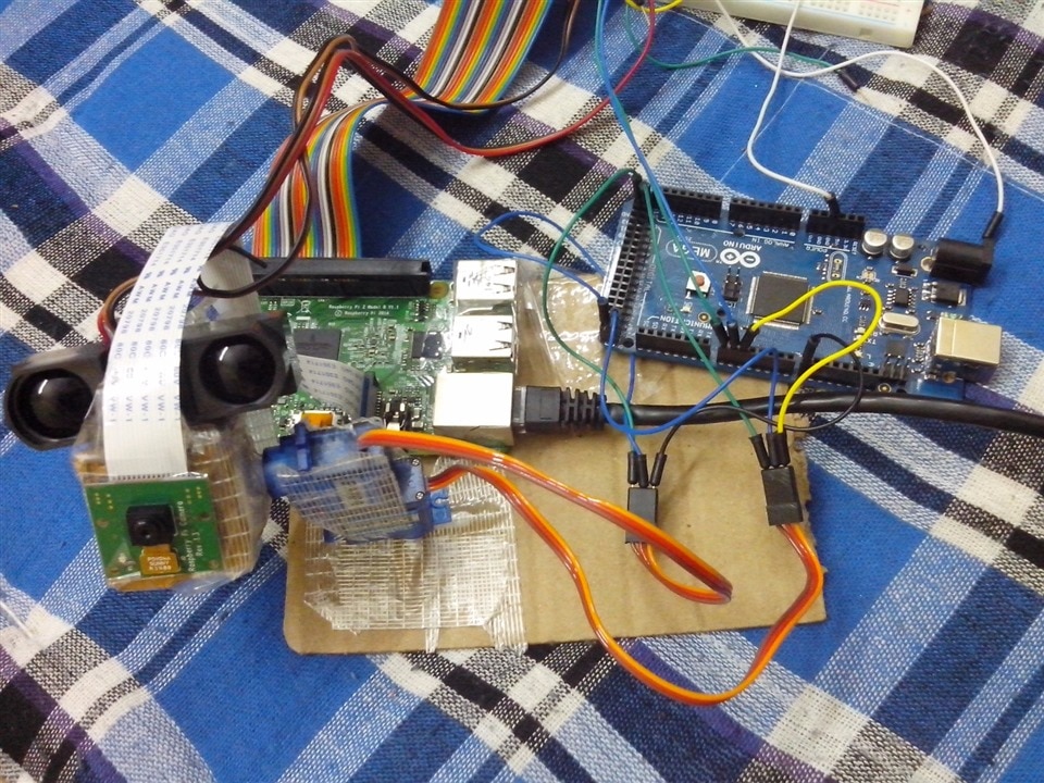

Apart from the servos and the micro-controller to control them, we need some mechanical structure as a platform to stage these servos. Now, take a look at the module I've made. Go ahead, make fun of it. I've made it in like 25 min with the help of things I could find in my storage. I've used a card board sheet as a platform for the module and used fiber reinforced duct tape to hold everything in place. But remember, if it works, it works.
Programming the Raspberry Pi :
All we have to do is perform an object detection, track the object and convey that information to arduino via Serial Ports i.e Tx and Rx. The rest of the job to control the servos depending on the data obtained from the Pi is left to the arduino.
Below is the code you've seen in the previous post; to perform an object detection and track by using color detection.
First, we initiate handles for Pi, cam, mcp3008 and serial transfer at 9600 Baud, to which arduino is also set. You should note that the file name is track.m and the command edit(file_name) constantly modifies the tracking pattern. We then take a set of snapshots and extract the RGB components from it and set it to detect green instead of blue as in previous post. We then accordingly threshold the image and find the mean of the center of the positive id of the detection. Transfer this information to the arduino as Serial write after converting it to appropriate code for controlling the Servo, which I'll explain in second half of this post. And later take the distance of object in front of distance sensor and Pi cam.

Programming Arduino to control Pan n Tilt module:
Now, after making necessary connections like power, Serial and PWM connections, burn up the code which initially declares handles for each of the two servos. Then , in the setup function, we assign servo's PWM connections to these handles and define a baud which we chose to be 9600. In the loop function, we take in the Serially sent values using Serial.parseInt function, not the general Serial.read function. This is because, the Serial.parseInt function automatically searches for numbers in the information sent without any complications. we then write these values to each of the Servo handles accordingly. Take a look a the code below.
#include <Servo.h>
Servo myservo1;
Servo myservo2;
int x,y,a=90,b=90;
void setup()
  myservo1.attach(2);
  myservo2.attach(8);
  Serial.begin(9600);
void loop()
{   while(Serial.available()){
  x=Serial.parseInt();
  y=Serial.parseInt();
  Serial.println(x);
  Serial.println(y);
  a=a+x;
  b=b+y;
  myservo1.write(b);
  myservo2.write(a);
delay(2);
The code works just fine but when sometimes it gets junk from serial communication, it may go wild, then you will have to reset the whole thing again.
