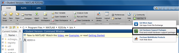

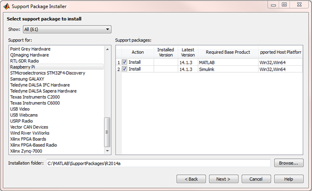

1) Open MATLAB and click the Add-Ons drop down menu on the top right. Click on Get Hardware Support Packages in the drop down menu to start the installer.

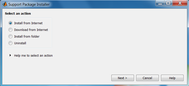

2) Select 'Install from Internet' as the source for installing the support package and click next.
3) On the list of support packages select Raspberry Pi and click Next, to install both the support packages at once.

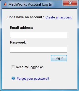

4) Log in to your MathWorks account. If you don't have a MathWorks account, you can create one during the install process or by visiting this page on the MathWorks website.

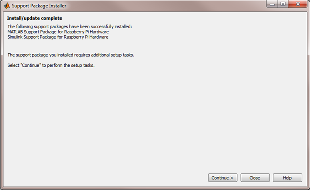

5) Once you accept the license agreement on the next screen, click Next through the following screens to finish the installation of both MATLAB and Simulink Support Package for Raspberry Pi.

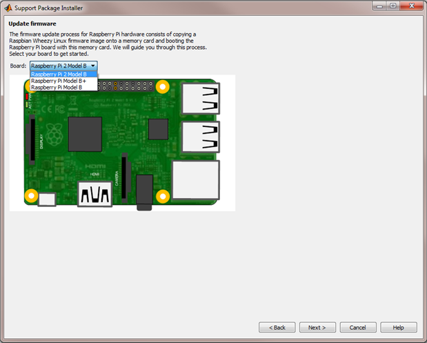

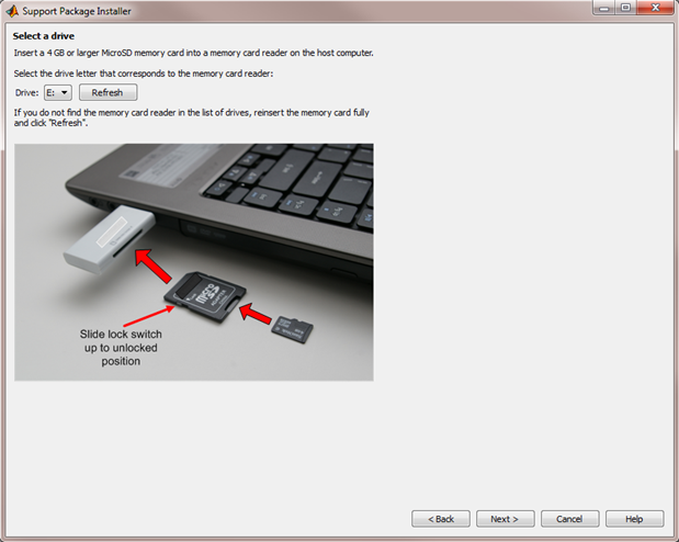

6) On the Firmware Update page, select the appropriate board (for this tutorial, Raspberry Pi 2 Model  B is chosen).

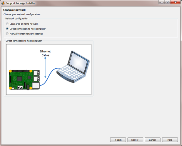

7) In the configure network screen, select Direct connection to host computer (to follow along with this tutorial).
8) In the next window titled 'Select a drive', the MicroSD cards that are detected by MATLAB will show up in a list format. If the MicroSD memory card does not get detected by MATLAB, but is detected by the OS - close MATLAB and restart MATLAB as an administrator. To continue with the process, the targetupdatercommand can be used in MATLAB.

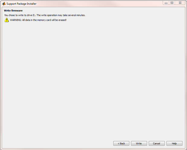

9) Select write option to erase existing items on the memory card and flash the latest firmware that is needed by the Support package. Click Next through the following screens to finish the installation for both MATLAB and Simulink Support Package for Raspberry Pi.

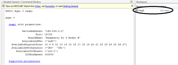

To establish a connection between MATLAB and Pi 2, the following command can be used from MATLAB.
>> mypi = raspi
This command connects MATLAB to the most recent successful connection to a Raspberry Pi board, including the setup process. A MATLAB variable by the name 'mypi' should now appear on the workspace or an error message indicating what went wrong. This object represents the connection that MATLAB has established with the physical object (Raspberry Pi).

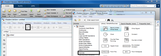

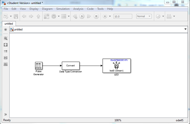

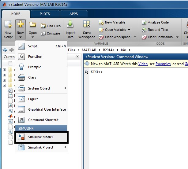

1) In MATLAB, select New > Simulink Model under the HOME Tab.
2) Click on the Library Browser Icon on the simulink model and go to Sources tab under Simulink in the Simulink Library Browser window.

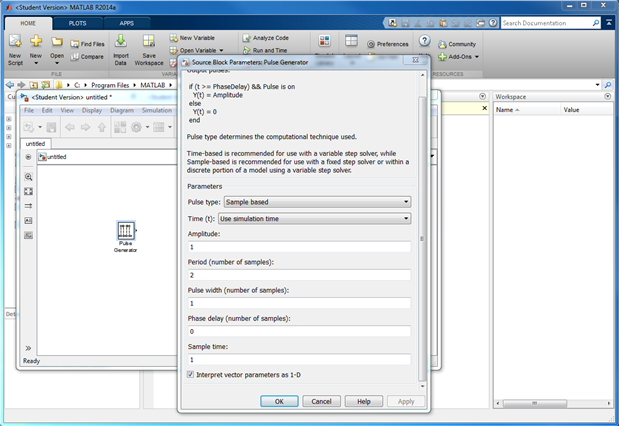

3) Drag the Pulse Generator block from the Sources library to your model and change the values as shown here.

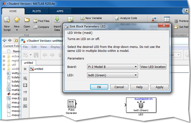

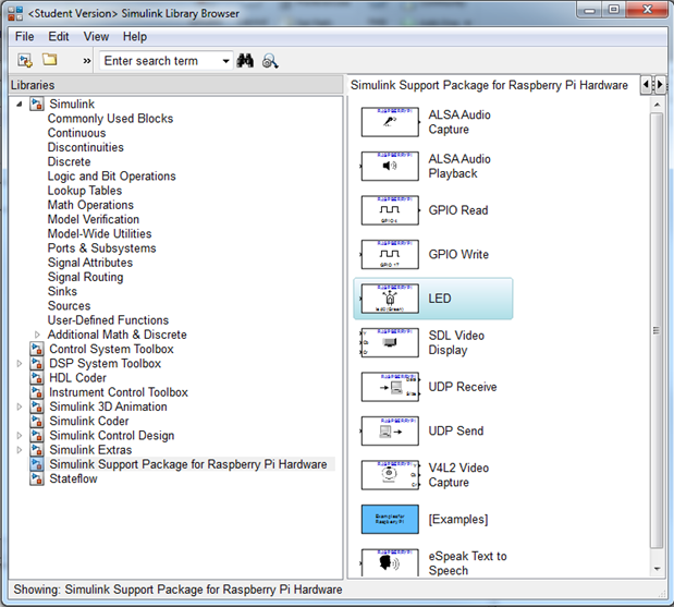

4) Use the LED Block from Simulink Support Package for Raspberry Pi Hardware in the Library Browser and change the parameters as shown here.

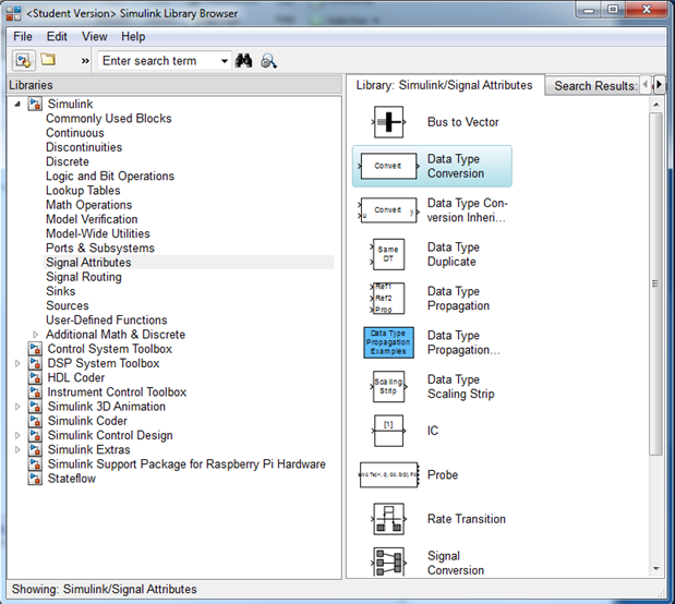

5) Drag and drop the Data Type Conversion block from the Signal Attributes tab under the Simulink library.
6) When you move the mouse pointer close to the arrow on the block, it will change to a plus sign. Left click when you seee the plus sign and drag the mouse to make the intended connection. Once the connection is made you can release the left click button.

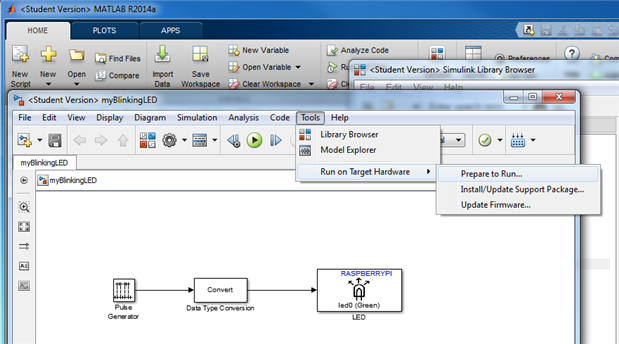

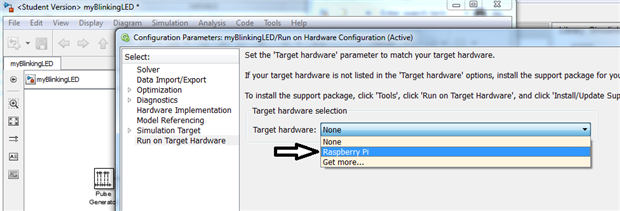

7)  Save this model and to configure the model go to Tools > Run on Target Hardware > Prepare To Run...
8) When the Configuration Parameters page opens up, set the Target hardware parameter to Raspberry Pi. Do not change any other settings.

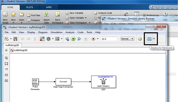

9) In your Simulink model, click the Deploy To Hardware button on the toolbar. Code will be generate from the model, which is then deployed to your Pi 2. The on-board LED should blink one time every second.
