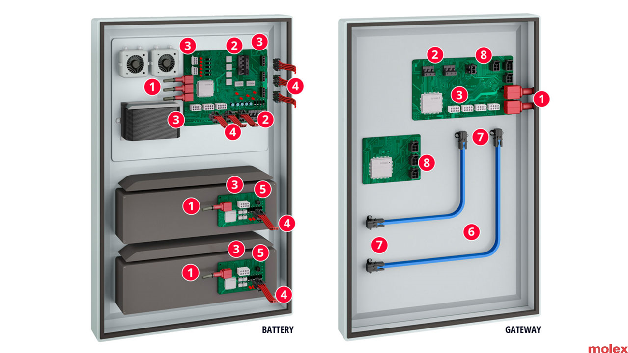

With a broad portfolio of connectivity solutions (Figure-1), Molex provides application-specific capabilities that enables engineers to address home energy storage challenges. From high-current interconnects, busbars, and power distribution solutions to compact connectors and cable assemblies, Molex interconnects enable reliable power transfer, robust thermal performance, optimized PCB utilization, and simplified system integration. These solutions help designers develop safe, efficient, and future-ready residential energy storage systems that support the growing demand for energy independence and smart home electrification.imageFigure-1: Connectors for Home Energy Storage Solutions (source: Molex)
  1. SW1 Connectors
  2. Terminal Blocks
  3. Mini-Fit Connectors
  4. Off-the-Shelf Power and Signal Discrete Wire Cable Assemblies
  5. Nano-Fit Connectors
  6. Busbars
  7. PowerPlane Busbar Connectors
  8. Mega-Fit Connectors
 Connector Type
Current
Circuits
Operating Temperatures
Wire Gauge
Pitch
SW1 Connectors
up to 300.0A
-40 to 125°C
Mini-Fit Connectors
up to 13.0A
2 to 40
up to 120°C
28 to 16 AWG
4.20mm
Mini-Fit Off-the-Shelf Power and Signal Discrete Wire Cable Assemblies
up to 13.0A
2 to 10
up to 120°C
24 to 14 AWG
4.20mm
Nano-Fit Connectors
up to 8.0A
2 to 16
up to 115°C
26 to 20 AWG
2.50mm
Nano-Fit Off-the-Shelf Power and Signal Discrete Wire Cable Assemblies
up to 8.0A
2 to 10
up to 115°C
20 AWG
2.50mm
Mega-Fit Connectors
up to 30.0A
2 to 12
up to 120°C
16 to 10 AWG
5.70mm
Power connectors for gateways provide this adaptability, offering a range of options that preserve PCB real estate while delivering the appropriate power to keep home energy systems running efficiently and reliably.

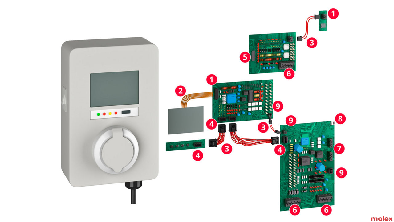

Residential Battery Energy Storage and Management Systems
Residential Battery Energy Storage and Management Systems play a vital role in supporting home energy independence, renewable energy integration, and reliable backup power. Unlike large-scale commercial systems, residential solutions require compact, space-efficient designs, serviceable layouts, and intuitive user interfaces that fit seamlessly within home environments. Designers must balance safety, thermal management, and reliability while ensuring efficient power distribution and long-term system performance. Molex addresses these challenges with a portfolio of compact, high-performance interconnects, busbars, and power distribution solutions that help minimize heat generation, optimize installation, and simplify maintenance.
Molex connectivity solutions support designers developing systems intended to meet UL 9540 and UL 1973 requirements, enabling safe, scalable, and reliable residential energy storage systems for the evolving electrification landscape.
Figure-2: Block diagram showing various connectors for Residential Battery Energy Storage (Source:Molex)
Figure-3: Residential energy storage controller highlighting Molex interconnect locations (Source: Molex)

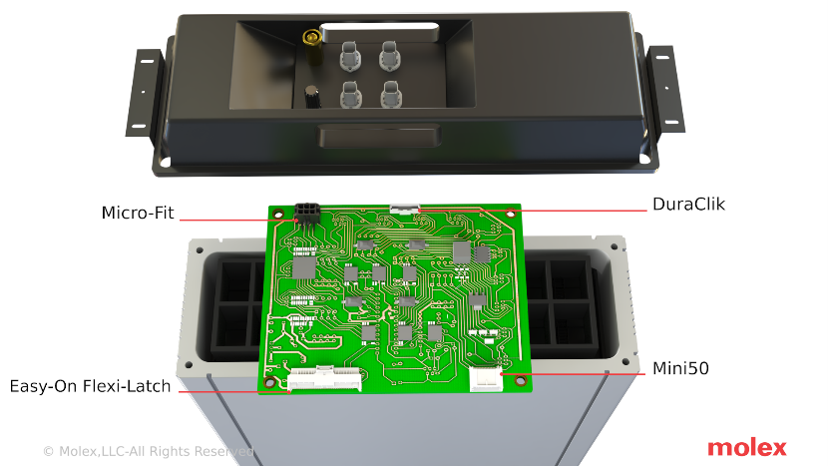

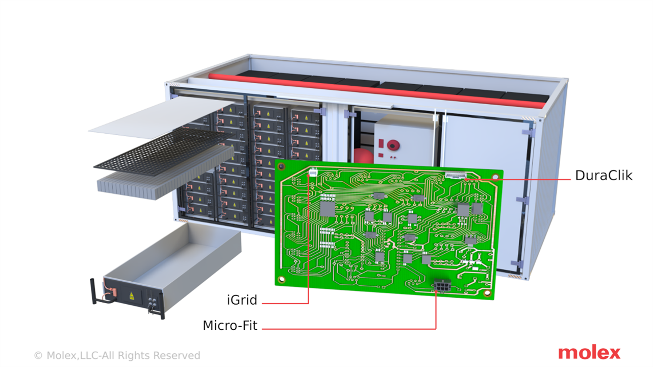

Battery Packs, Monitoring and Control Systems
Battery Pack Connectors for Energy Storage Systems
Battery Energy Storage Systems increasingly rely on compact, high-density battery pack architectures, making efficient signal routing a critical design consideration. In tightly packed battery modules, conventional interconnect solutions can consume valuable space, increase system complexity, and create the risk of mechanical interference during assembly and operation.
To address these challenges, Molex offers ultra-compact connector solutions specifically designed for battery pack and battery management system (BMS) applications. Featuring low insertion force, space-saving footprints, and secure locking mechanisms, these connectors simplify signal routing within confined enclosures while protecting mating interfaces from assembly-related damage. By enabling reliable signal transmission, improved PCB utilization, and streamlined integration, Molex helps engineers design smaller, safer, and more efficient battery storage systems without compromising performance or long-term reliability.
Connector Type
Configuration
Pitch 
Current (max.)
Wire Gauge
Circuits
C-Grid and C-Grid III Connectors
Wire-to-board, board-to-board
2.54mm
3.0A
36 to 22 AWG
1 to 100
iGrid Connectors
Wire-to-board
2.00mm
3.0A
28 to 22 AWG
10 to 40
Nano-Fit Connectors
Wire-to-board, wire-to-wire
2.50mm
8.0A
26 to 20 AWG
2 to 16
Mega-Fit Connectors
5.70mm
30.0A
18 to 10 AWG
1 to 12
Micro-One Connectors
Wire-to-board
2.00mm
4.0A
28 to 22 AWG
2 to 8
Mini-SPOX Connectors
Wire-to-board
2.50mm
4.0A
28 to 22 AWG
2 to 15
DuraClik Connectors
Wire-to-board
2.00mm
3.3A
30 to 22 AWG
2 to 24
Mini50 Connectors
Wire-to-board
2.00mm
4.0A
26 to 22 AWG
2 to 38
ConnTAK50 Connectors
Wire-to-board
1.80mm
6.0A
26 to 22 AWG
2 to 6 circuits (single row), 10 and 22 circuits (dual row)
Battery Management System (BMS) PCB and Signal Interface Connectors
Battery Management Systems (BMS) serve as the intelligence layer of BESS, continuously monitoring battery health, voltage, temperature, charge status, and overall system performance. As modern BMS designs become increasingly compact and feature-rich, engineers face the challenge of routing both power and signal connections within densely populated PCBs while maintaining reliability, signal integrity, and efficient board utilization.
To address these requirements, Molex offers miniaturized and modular connector solutions that support both power and signal transmission through a single interface. These space-saving interconnects enable flexible mixed-function layouts, simplify PCB routing, and help maximize available board space without compromising performance. By providing reliable connectivity in compact designs, Molex solutions support efficient BMS integration, improved system monitoring, and enhanced reliability in next-generation energy storage systems.

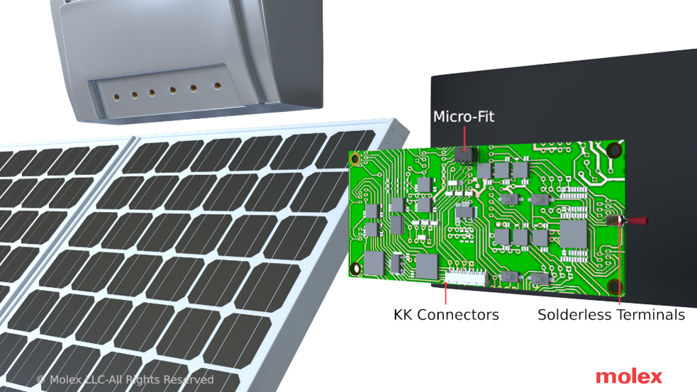

Renewable Energy Systems
Solar Energy Systems
As solar energy systems continue to play a critical role in renewable energy generation, designers require reliable connectivity solutions that ensure efficient power distribution, system monitoring, and long-term operational performance.
Micro-Fit Connectors provide compact, high-performance power and signal connectivity for solar inverters and power management electronics, helping optimize PCB space while ensuring reliable power transfer. KK Series Connectors enable dependable board-level signal and control connections for monitoring, sensing, and communication functions within solar control systems. Solderless Terminals simplify field wiring and installation, reducing assembly time while providing secure and serviceable power connections.
Together, these Molex connectivity solutions help solar system designers improve reliability, simplify installation, support efficient power management, and enhance the long-term performance of solar energy infrastructure.
Figure-4: Connectors used in solar energy system (Source: Molex)
Molex enables efficient solar energy systems with compact power and signal interconnects, supporting reliable inverter control, system monitoring, and simplified field installation for long-term renewable energy performance.
Molex Connector
Primary Function
Typical Solar Application
Key Benefits
Micro-Fit Connector System
Power and signal connectivity
Solar inverter control boards, power management units, DC-DC conversion stages
Compact 3.00mm pitch, up to 10.5A current capability, secure mating
Signal and control connectivity
Solar monitoring circuits, sensor interfaces, communication modules, control boards
Proven wire-to-board design, multiple pitch options, flexible configurations
Field wiring and power termination
Solar combiner boxes, inverter power inputs, system wiring connections
Quick installation, secure termination, simplified maintenance

Commercial and Industrial Energy Storage System
Commercial and industrial BESS designs require reliable connectivity solutions to support high-current power distribution, battery monitoring, power conversion, and system control functions. As energy storage installations become larger and more power-dense, designers must address challenges related to thermal management, space optimization, signal integrity, and long-term system reliability.
Figure-5 highlights Molex connectivity solutions including Micro-Fit Connectors, iGrid Connectors, and DuraClik Wire-to-Board Connectors, which enable efficient power and signal routing within BMS, controller board, and monitoring electronics.
Figure-5: Teardown of connectors used in Commercial and Industrial Battery Energy Storage Systems (Source: Molex)
Connector
Primary Role
Key Benefit
Micro-Fit
Power & signal connectivity for BMS and control boards
Compact design with reliable power delivery
iGrid
Signal routing and battery monitoring interfaces
Space-saving, high-density PCB connectivity
DuraClik
Sensor, communication, and monitoring connections
Positive lock and vibration-resistant performance
Micro-Fit Connectors provide compact and reliable power and signal connectivity for BMS and control systems, while iGrid Connectors deliver space-saving signal connections for densely populated PCBs. DuraClik Connectors offer secure locking, vibration resistance, and dependable signal transmission for sensing, monitoring, and communication interfaces. Together, these solutions help energy storage designers improve reliability, optimize PCB space, simplify integration, and support scalable commercial and industrial energy storage architectures.

Figure-6: Connectors used in an EV charging unit (Source: Molex)
  1. Easy-On FFC/FPC Connectors
  2. Premo-Flex FFC/FPC Jumpers
  3. Micro-Latch Off-the-Shelf Discrete Wire Cable Assemblies
  4. iGrid Wire-to-Board Connectors
  5. SlimStack Board-to-Board Connectors
  6. Terminal Blocks
  7. Micro-Latch Wire-to-Board Connectors
  8. Memory/SIM Card Connectors
  9. Nano-Fit Connectors
Molex provides a broad portfolio of board-to-board and FFC/FPC connector solutions that offer multiple pitch sizes, circuit configurations, and compact form factors, enabling efficient PCB utilization and simplified system integration. For user interface and display systems, Molex FFC/FPC connectors provide miniaturized, secure, and easy-to-assemble interconnect solutions that help reduce assembly time while ensuring reliable mating in space-constrained designs. Additionally, as EV charging stations increasingly rely on cloud connectivity for payment processing and remote diagnostics, Molex communications connectors deliver reliable high-speed data transmission using compact, polarized designs that prevent incorrect insertion and support dependable operation. Together, these connectivity solutions help manufacturers accelerate time-to-market while delivering reliable, feature-rich, and future-ready EV charging stations.
