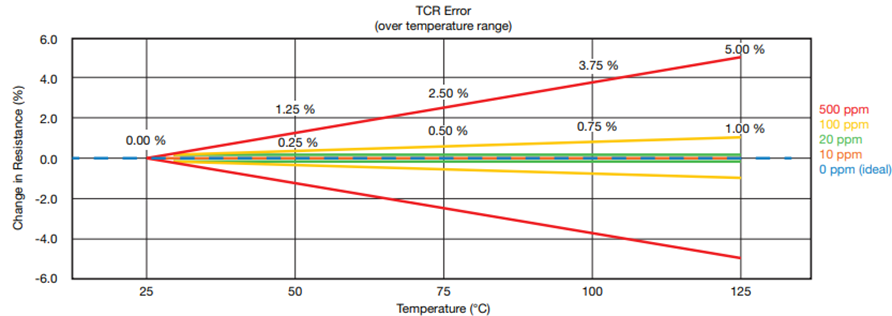

Why Does TCR Matter in Precision Sensing?
Resistance isn’t constant—it changes with temperature. The TCR quantifies this change, expressed in parts per million per degree Celsius (ppm/°C). In simple terms, TCR tells us how much a resistor’s value will drift as the temperature fluctuates.
If a resistor has a positive TCR, its resistance increases with rising temperature. A negative TCR means resistance decreases as it gets warmer. In either case, too much variation can compromise measurement accuracy. A low TCR is critical in precision current sensing, especially in systems where even the slightest error can cascade into larger problems. Due to increased electron scattering, most metals naturally see resistance rise with temperature. However, specialized alloys — such as the manganese-copper used in Vishay's WSBE8518 shunt resistor —can achieve remarkably stable performance, with TCRs as low as ± 10 ppm/°C. This makes them ideal for applications demanding high accuracy under wide temperature swings.
For instance, a 1 mΩ shunt with a TCR of ± 50 ppm/°C will experience a resistance change of ± 5 µΩ over a 100 °C temperature swing, which is equivalent to ± 0.5 % of its nominal resistance. That may seem insignificant, but in high precision environments such as battery charge balancing or power regulation, such deviations can skew current readings and disrupt system performance. The following equation calculates the maximum change in resistance value for a given TCR:
R = R0 X 1 [ 1 + α(T-T0)]
where,
R = final resistance
R0 = initial resistance
α = TCR
T = final temperature
T0 = initial temperature
Figure 2: This graph compares different TCR levels as a percentage change
in resistance versus increasing temperature from 25 °C
The benefits of low TCR are:
  • Improved measurement accuracy: With resistance remaining stable across temperature variations, current sensing becomes more precise
  • Better thermal stability: Minimal resistance drift, even under fluctuating ambient conditions or due to self-heating from applied power
  • Ideal for high precision circuits: Supports applications that require consistent performance over wide temperature ranges
  • Enhanced performance in harsh environments: Suitable for military and high temperature electronics where reliability under thermal stress is critical
  • Minimizes error in Kelvin configurations: Particularly advantageous in 4-terminal setups in which precise voltage sensing is critical

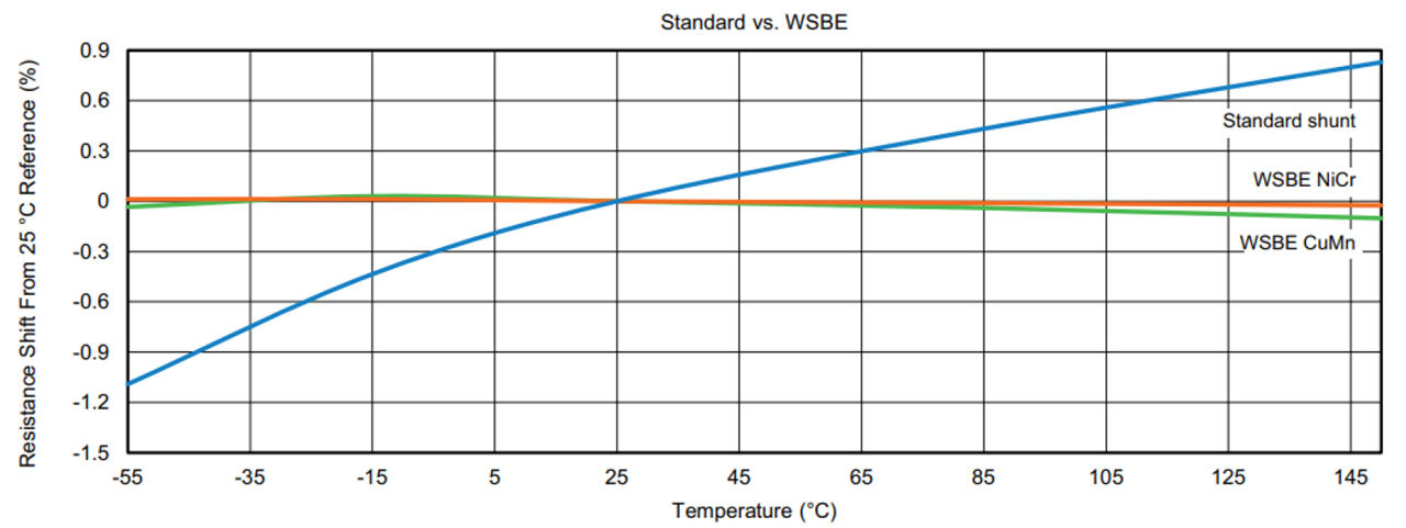

Figure 3 illustrates the superior thermal stability of WSBE series resistors (NiCr and CuMn) compared to standard shunt resistors. While the standard shunt exhibits a large resistance drift over temperature (indicative of poor TCR), the WSBE resistors maintain almost constant resistance across a broad thermal range.
Figure 3: TCR comparison chart (WBSE series vs a standard shunt resistor)
Source: New WSBR Dual-Element Shunt With TCR Immunity for ASIL-D Safety Standards

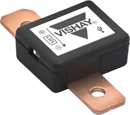

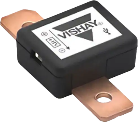

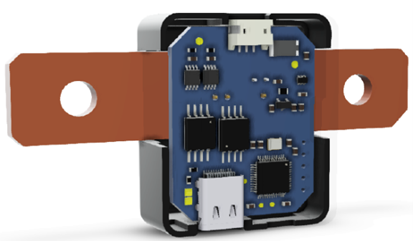

Introducing the High Voltage Intelligent Battery Shunt Reference Design (HV-IBSS-USB)
Vishay's HV-IBSS-USB reference design is a powerful evaluation kit engineered to simplify the assessment of their advanced WSBE8518 low TCR Power Metal Strip shunt resistors. The design incorporates the WSBE8518 (100 μΩ, ± 10 ppm/°C) and CDMA2512 (50 MΩ) resistors, achieving an overall TCR of approximately 44 ppm/°C without thermal compensation.
image image
Figure 4: HV-IBSS-USB reference design board
Source: (HV-IBSS-USB) Reference Design
Unlike conventional evaluation kits limited to component-level testing, the HV-IBSS-USB offers a comprehensive, isolated platform tailored for accurate real-world, high voltage current sensing applications. Its intelligent architecture integrates real-time current, voltage, and temperature monitoring via a standard USB interface. It enables engineers to rapidly validate performance, thermal behavior, and long term stability without custom measurement setups. Key features and benefits of the HV-IBSS-USB include:
  • Isolated USB interface: this facilitates direct connection to a PC for data logging, real-time monitoring, and configuration via a user-friendly graphic user interface (GUI)
  • Factory calibration: provides 0.2 % accuracy for currents up to ± 500 A
  • Wide operating range: supports voltages from 10 V to 850 V
  • Isolated design: separates high voltage (HV) and low voltage (LV) domains for safety
  • Temperature monitoring: an NTC thermistor is used for thermal analysis

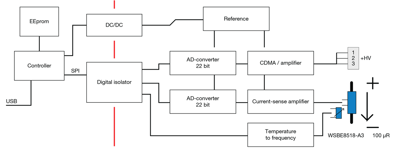

How the Reference Design Works
The HV-IBSS-USB reference design features two isolated domains: an HV analog front-end and an LV digital control section. Powered and interfaced via USB, the LV side hosts a microcontroller that manages data acquisition and communication. Power is transferred to the HV domain through a charge pump, where precision 22-bit sigma-delta ADCs and carefully selected analog components enable high resolution current and voltage measurements.
The design compensates for thermal drift through automatic gain and offset calibration, ensuring accuracy across temperature variations. A dedicated voltage divider feeds the voltage signal directly to the ADC, eliminating amplifier drift. An NTC-based converter transmits a PWM signal across the isolation barrier for temperature monitoring. Data is available via a virtual COM port, auto-detected over USB, enabling seamless integration with PC-based tools.
  • Current measurement: a third-order delta-sigma modulator converts the voltage drop across the WSBE8518 shunt into a digital signal, with automatic gain and offset calibration. The shunt’s TCR (10 ppm/°C) outperforms the analog circuitry’s drift (33.6 ppm/°C), ensuring high accuracy
  • Voltage measurement: a 22-bit sigma-delta ADC measures voltage, divided by the CDMA2512 resistor to fit the ADC’s range
  • Temperature measurement: an NTC thermistor and multivibrator convert temperature to a frequency signal, transmitted as a PWM signal to the microcontroller
Figure 5: Functional block diagram of the HV-IBSS-USB

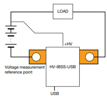

Application: EVs
In BMS for EVs and other compact mobility vehicles such as electric two-wheelers, precise current measurement is critical for monitoring charge and discharge cycles, balancing cells, and ensure safe, efficient operation. The HV-IBSS-USB facilitates the evaluation of the WSBE8518 shunt in these demanding environments. Installed in series with the high voltage battery pack, the shunt accurately measures currents up to  500 A, which is ideal for applications where currents routinely exceed 100 A.
The reference design’s USB-C interface enables real-time data logging, allowing engineers to analyze current flow, detect anomalies, and fine-tune battery management algorithms. The WSBE8518's low TCR ensures accurate measurements even as operating temperatures rise during rapid charging or high load discharge. Voltage measurements spanning 10 V to 850 V and integrated temperature sensing provide additional data for detecting faults or optimizing power distribution.
A typical application circuit places the shunt between the EV battery and the drive or charging system. The HV-IBSS-USB's HV+ and HV + terminals connect to the shunt's Kelvin terminals, and the USB-C port links to a computer for data acquisition and analysis.
Figure 6: Typical application circuit

    Im kinda surprised to see USB rather than canbus. Im also kinda surprised to not see an optical interface to apply the shunt in higher current and voltage applications, broader than just EVs.
  • michaelkellett
    michaelkellett over 1 year ago in reply to robogary +1
    It looks as if it is designed to be cheap - low side non isolated current sense and USB for power and comms - but then it isn't actually cheap at £232. The current shunt (which is the good bit) costs …
  • michaelkellett
    It looks as if it is designed to be cheap - low side non isolated current sense and USB for power and comms  -  but then it isn't actually cheap at £232. The current shunt (which is the good bit) costs £17.
    USB is great if you just want to plug into a PC for a quick play, but as soon as you want to integrate into a system it becomes a real pain. My usual solution to this is to use an FTDI chip for USB virtual com port, but to provide jumpers and access pins so you can bypass the FTD and talk via logic level UART, which gives you simple low cost access that works with just about any processor.
