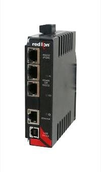

DA10D IIoT Protocol Conversion with RS232 and RS485

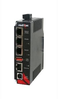

High Performance Protocol with Data Logger, Web Server and Virtual HMI

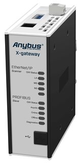

X-Gateway, Anybus, EtherNet/IP Scanner to PROFIBUS Slave

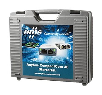

Anybus CompactCom 40, starter Kit - Pluggable Brick
