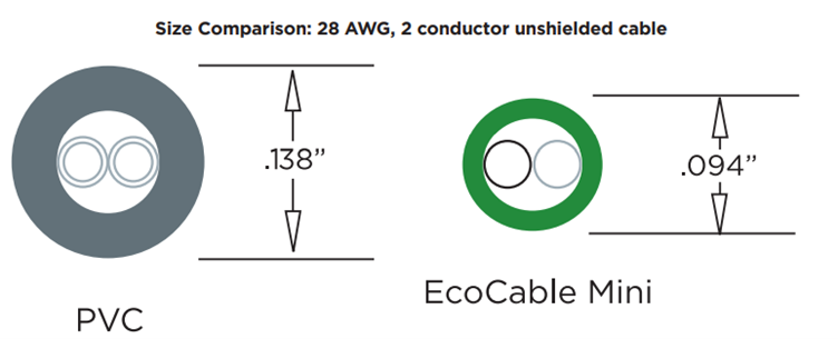

Insulation and Shielding: The choice of insulating and jacketing materials is critical for signal integrity. Polyolefin-based insulations, such as polyethylene and polypropylene, offer superior dielectric properties compared to PVC, while also providing high strength and low density. This means less total material and a slimmer, lighter, and more flexible cable. In environments prone to EMI, such as those with motors, shielded cables are essential to minimize noise and signal degradation. For example, a double-layer cable with foil tape and 95% braid can reduce surface transfer impedance by 1/5, while preserving impedance (100-120 Ω) in high-speed data links.
Figure 1: EcoCable Mini® cable with mPPE jacket offers the advantage of up to 92% lower outgassing than PVC control cable(Source: Belden)

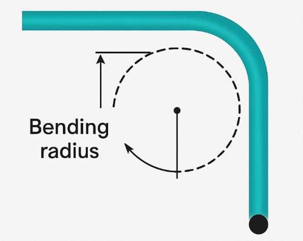

Bending Radius: It is the minimum radius formed by the cable's centerline when it is bent. For cables in a dynamic environment, the recommended minimum bending radius is typically a multiple of the cable's outer diameter (OD), often ranging from 4 times to 12 times the OD. Bend radius requirements vary depending on the type of cable. For example, flexible cables can tolerate smaller bend radii, whereas high-voltage wires or fiber optic cables require larger bend radii for safety and optimal performance.
Figure 2: Illustration of bending radius of a wire

EcoCable Mini®: This is the newest addition to Alpha Wire's EcoGen® family of environmentally friendly, high-performance cables. Developed specifically for applications requiring a smaller, lighter, 300 V cable, it offers significant space-saving advantages over standard PVC cable. This makes it an ideal choice for intricate, compact designs in a variety of equipment. The key features are:
  • Smaller and Lighter: Engineered with mPPE insulation and jacketing, making it up to 32% smaller and 44% lighter than traditional 300 V PVC cables. This allows for easier routing and installation in tight or densely packed areas.
