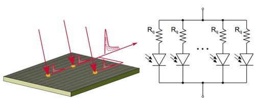

SiPMs are solid-state photodetectors composed of arrays of Single-Photon Avalanche Diodes (SPADs) operating in Geiger mode. When a SPAD is biased above its breakdown voltage, it becomes highly sensitive to light and can trigger an avalanche event from a single photon interaction. This mode of operation is known as Geiger mode. It enables the detection of extremely weak light signals, down to individual photons.
In a typical SiPM, several hundred to thousands of SPADs are connected in parallel (Figure 1). Each SPAD is equipped with an integrated series resistor that quenches the avalanche and resets the diode quickly, allowing it to be ready for the next photon. The combined output of these SPADs results in a current pulse proportional to the number of incident photons, producing a high-gain signal (>1 × 10⁶) with excellent time resolution.
Figure 1: A SPAD arrangement and SiPM signal formation with schematic
Source: Broadcom AFBR-S4XX Brief Introduction to Silicon Photomultipliers, Application Note)
SiPMs generate fast, quasi-digital pulses with sub-nanosecond rise times, making them ideal for time-critical applications such as LiDAR, TOF-PET, and fluorescence lifetime imaging. Their internal amplification mechanism ensures a high signal-to-noise ratio, and their design minimizes dark counts and afterpulsing, which is crucial for precise photon counting in low-light environments.

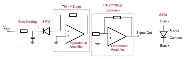

The typical SiPM design can be either p-on-n or n-on-p, depending on the target spectral sensitivity. Figure 2 shows the typical nomenclature and polarity for reverse biasing. The positive SiPM bias voltage is applied to the cathode; the SiPM signal is read out via the anode and fed into a transimpedance amplifier (TIA). The voltage signal can subsequently be further processed and digitized.
Figure 2: Common readout design comprising a transimpedance amplifier
(Source: Broadcom AFBR-S4XX Working with Broadcom SiPMs, Application Note)
The best way to read a SiPM depends on the application and signal requirements. It can be DC- or AC-coupled, and signal amplitudes can be increased or reduced using amplifiers or attenuators. A common readout design is a transimpedance amplifier (TIA), which can be realized using various operational amplifiers. The choice of amplifier depends on the end application's performance requirements. A single-stage transimpedance amplifier can be used for moderate gain or low bandwidth.

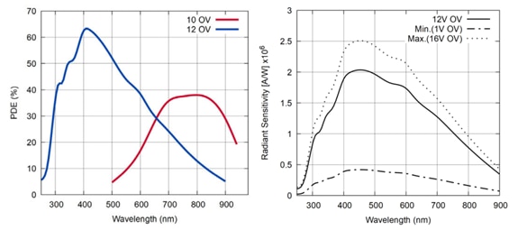

Broadcom offers two distinct families of SiPMs: Near Infrared (NIR) and Near Ultraviolet (NUV). The NIR SiPM family is designed for near-infrared applications, making it ideal for automotive and industrial LiDAR, ranging systems, and life sciences. It offers exceptional performance in parameters like PDE, crosstalk, afterpulsing, and recovery time. The NUV-MT SiPM technology enhances performance in applications like Time-of-Flight Positron Emission Tomography (TOF-PET), flow cytometry, radiation and X-ray detection, X-ray photon counting, and line-of-sight data communication, making it ideal for demanding applications.SiPM efficiency is expressed as PDE (photon detection efficiency), the parameter to compare to a PMT’s quantum efficiency (QE). With a PDE of 63% at 420 nm (NUV SiPM) and a PDE of 38% at 800 nm (NIR SiPM), Broadcom SiPMs achieve an efficiency superior to most available PMTs (Figure 3).
Figure3: SiPM PDE (Left for Broadcom NUV and NIR SiPMs) and Radiant Sensitivity (Right for NUV SiPMs)
(Source: Broadcom AFBR-S4 SiPMs in Life Sciences: Overcoming Limitations of PMTs, White Paper)

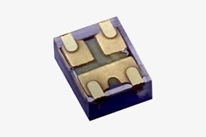

imageAFBR-S4N22P014M
Silicon Photomultiplier, 2mm × 2mm, 40µm/2464 Microcells, 420nm, Array, 4 Pin

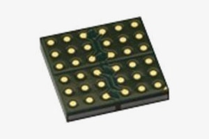

imageAFBR-S4N44P044M
Silicon Photomultiplier Array, 3.72mm × 3.62mm, 40µm/8334 Microcells, 420nm, SMD, 36 Pin

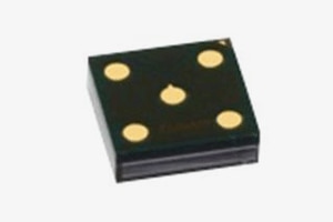

imageAFBR-S4N44P014M
Silicon Photomultiplier, 3.72mm × 3.62mm, 40µm/8334 Microcells, 420nm, SMD, 5 Pin

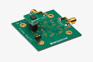

imageAFBR-S4E001
Evaluation Board, Photomultiplier Sensor

    Definitely keen to try out one of these Broadcom parts once I figure out the amplifier circuit. Can't see the schematic online for the Evaluation Kit.  e14sbhargav   please could Broadcom supply the schematic and board files? It's in the manufacturer's interest to supply an example or reference schematic, otherwise it's much harder for engineers to get going with their parts.
