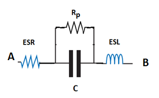

Figure 2 represents the equivalent circuit of a capacitor, where A and B are the capacitor terminals.  The circuit includes the effective resistance, and some parasitic inductance (ESL) due to electrodes, leads, and geometry. The shunt resistance(insulation resistance) accounts for the DC leakage current. Heat is generated in the ESR from ripple current and in the shunt resistance by voltage.
ESR is the real resistive component of the complex impedance Z(Ω) = R + j X(Ω) of the device. This complex impedance can involve several relatively minor capacitances. These small deviations from the ideal behavior of the device can become significant when operating under certain conditions, i.e., high frequency, high current, or temperature extremes. ESR is often represented in the mathematical relationship:
                         ESR = DFXc = DF/2πfC ……………………(1)
where, DF is dissipation factor, and Xc is capacitive reactance in ohms
Figure 2: Equivalent circuit of a capacitor

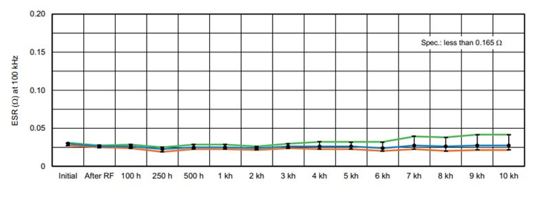

Polymer capacitors have lower ESR because they use inherently conductive polymer (ICP) materials as electrolytes. The electrical conductivity of ICP is several orders of magnitude higher than that of its liquid counterpart. The presence of ICP in the electrolyte of these capacitors offer a much more efficient path for charge transfer, providing superior conductivity and drastically reducing internal resistance. Figure 3 displays the kind of long term stability seen in polymer technology, with minimal change in ESR over time.
Figure 3: Long term stability of a polymer capacitor, with change in ESR over time (Source: Vishay)
