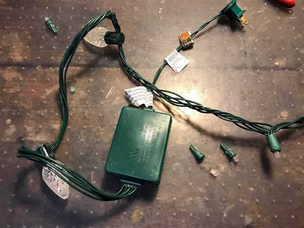

I could use some help choosing replacement 4-pin RGB lamps for my In Motion outdoor Xmas sets.  I have 20 twelve-lamp “C9” sets on the house, end to end, each with a control module.  They manage to stay in synch, so the modules must be absolutely identical electronically.  Color combinations and solids rotate in sequence and can be steady or flash, etc.  The colors include white, purple, orange, etc., not just RGB, so the controllers apparently mix RGB with varying current I assume.
When new I had sets that acted up, with sections of 3 or 4 lights staying solid white, or occasionally groups of lamps entirely out.  The mfr. ultimately sent me more than 20 new sets, so usually now I just replace an entire faulty string with one of those, and later try to fix the original.  But that’s a nightmare, and I now have 7 or 8 sets from years past clogging my workbench.  Sometimes just juggling lamp positions works, but usually it’s a bugger ferreting out what’s wrong.  It’s easy to suspect the controllers, but sometimes just replacing just the right lamp with a spare does the trick.  But because there are 4 wires instead of just 2, I have a devil of a time finding the faulty lamp;  my yellow LED Xmas gun isn’t useful on controlled 4 pin lamp sets.

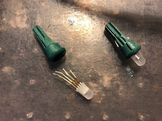

Since there only 2 spare lamps in holders with each set (and some sets had no spares), I’d like to get spare 4-pin bulbs.  If I just replace lamps one at a time until a set works, since they fail in straight groups of 3, that may be easiest.   The pins are too long and often need trimming a bit to fit the holder or they jam going into the sockets.  Problem is I’m not sure which lamp to order.  Maybe you can assist.  The tag on each cord says to replace with 3v fuses, and 4v. 0.25 w lamps.  That’s it.  In searching online I see options on Amazon (Chanzon), but they are clear lenses and mine are diffused.  The ones at Amazon say 3v.  More concerning is they come either common anode or common cathode, and I don’t know how to tell which that mine are.  They are domed 5mm.  I looked at Mouser.com but was still left with uncertainty.
Can you advise?  I’d sure like to clear these 7 or 8 sets off my garage workbench, and for once have room for other projects as they come up!

    I placed the question more than once and on separate boards because I got no reply the first time some days ago, and this time there was no confirmation it went when I hit the submit button.
    Thanks Frank.  I assume because three of the lamp leads are the same polarity and are RG & B.  I can clip the second power supply lead to any of them?  I am confused about the word “common”... does it refer to the 3 that have a common charge, or the single lead that I’m measuring that is the only one with that charge?  In a 2-lead LED lamp the short lead is the cathode (negative) and is on the flattened rim side of the lens.  But sales images online of 4-lead ones show the second lead in from the flat side to be the longest, and it has one charge;  the other 3 leads share the opposite charge.
    My power supply is 0-30v and 0-10 amps.  But I don’t know if I can fine tune it down to .0625a or .083a.  I previously mentioned that the UL tag on each set said, “replace with 4v  .024 watt spare lamps”.  .024w/4v=.0625a.  .024w/3v=.083a.  The lamps I see on Amazon are around 3v I think, but not frosted.  I will look further at element14/Newmark.
    Sorry for my naïveté, but I just thought I had standard LED lamps figured out, and along come 4-leaded ones.

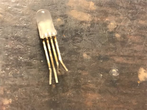

    The photos of my lamps don’t show a long lead because the mfr. clips them off to fit their lampholders.  But I’m assuming the long lead will be the second one in from the flattened lens rim side.
    Joel

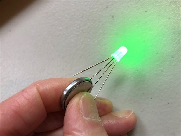

    The video that Ralph linked appears to go into more depth and will provide useful information.  The language on the tag is confusing.  The LEDs don't really work at 4V or for that matter 3V.  Depending on the color and way they were manufactured, they will start to conduct at different voltages called the forward voltage.  For example, the red LED inside the case will probably start to conduct and thus light up around 1.6V.  The voltage drop across the LED will remain fairly constant once it is at the forward voltage.  The green maybe lights at 2V and the blue maybe at 2.5V depending on how they were made. The LEDs will probably fail quickly if the current is more than 20 mA for very long which is why I suggested putting a resistor in line.  The controller on your LED strings probably has a constant current source to keep the LEDs from burning out too quickly.

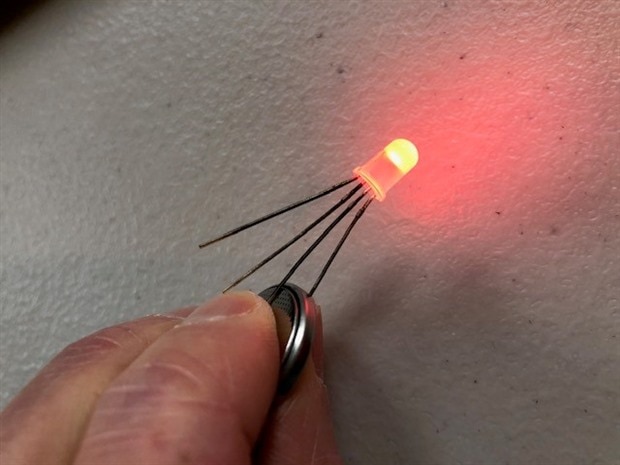

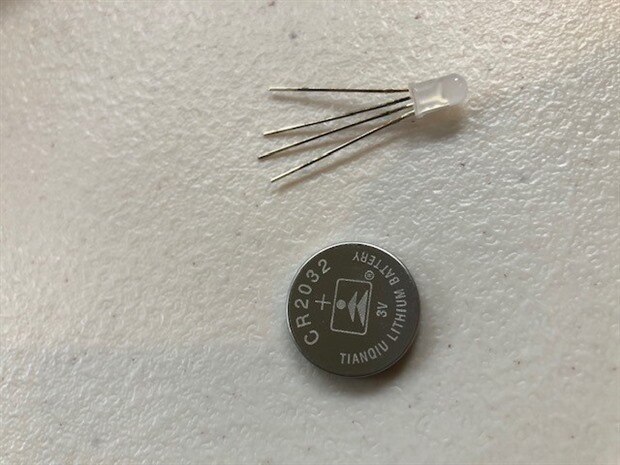

    Below is a photo of a LED I have at hand along with a 2032 button cell battery which puts out a voltage of around 3.2 V.  The battery has internal resistance so it can't put out enough current to damage the LED.
    The current will only flow in one direction and the LED will block in the other direction.  On my LED the long leg is the cathode, or negative.  If I place the positive side of the battery between the other legs and the long leg / cathode the LED lights up.  For example, the leg to the far right lights the red LED when the negative side of the battery is pressed against the long leg.

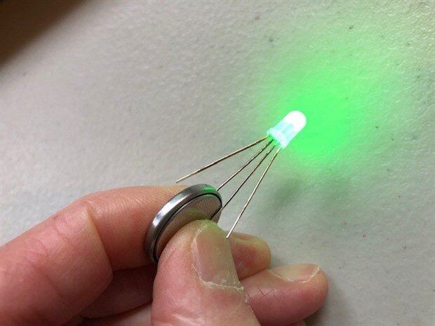

    And the leg just to the left of the cathode / long leg lights the green LED.

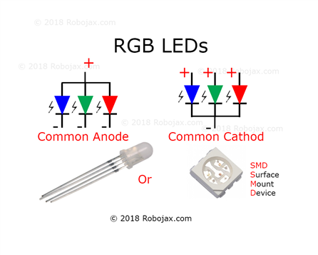

    The last leg on the far left will be the blue.  Notice that I always have to press the negative side of the battery against the long leg or cathode of the LED.  That is why it is called a common cathode LED - the cathode is common to all colors.  Some LEDs are made with a common anode where current flows in via a common leg but the cathodes are separate and thus control is done by switching on the ground side.  So, it is important to determine which type you have and always place the LED into the socket in the correct orientation or it won't light up.
    I am going to guess you have 5mm common cathode with 0.1 inch pitch which is what I have seen the most but check.  Frosted or non-frosted will work with perhaps a somewhat different look due to brightness.  Let us know if you have more questions.

    I tried the 3v button test on a standard 2-pin lamp and it easily lit as it should.  But I can’t get these 4-pin ones to work that way no matter whether the common is touching + or - .  I tried unused spare bulbs fresh out of the package with the same result.
    Are we absolutely sure they can’t be 4 volt lamps?  I can’t get my power supply to set at .06 amp and 4 v.  to match the set’s replacement claimed 4v 0.25 watt lamps, so I can’t test that way what the common pin is as I’d hoped.  I don’t see 4v LEDs available online, but am still looking.

    They may have resistors installed to work at 4 V or some other scheme I haven’t seen.  If you can spare some LEDs then just slowly turn up your power supply and see what happen.  They should light up briefly even if you toast them and you can determine the equivalent forward voltage and whether they are common anode or cathode. Else you can put current limiting resistors (edit: or a potentiometer so that you can ramp up current) in series as suggested earlier. If all else fails let me know and I will give you my address by private message so you can send one to me and I will test it.
