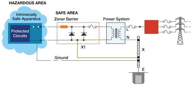

What is an Intrinsically safe apparatus?
Intrinsically safe apparatus is defined as equipment and wiring which is incapable of releasing enough electrical or thermal energy under normal or abnormal conditions to cause ignition of a hazardous atmospheric mixture. This is achieved by preventing electrical equipment from becoming sources of ignition of explosive atmospheres in two ways:
  • Energy limitation – To limit the spark energy
  • Temperature limitation – To limit the surface temperature
For Class I hazardous locations, flammable gases or vapors can be ignited by sparks caused by electronic switching, arcing, or by the high surface temperature of parts exposed to the explosive atmospheres. For Class II and III hazardous locations, the main concern is that the apparatus's surface temperature may trigger an explosion if the temperature is higher than the ignition point of (for example) combustible dusts.  Intrinsic Safety (IS) is a practical method of achieving such protection. Figures 1 and 2 show examples of common intrinsic safety systems.
Figure 1: Intrinsic safety system using zener barrier
