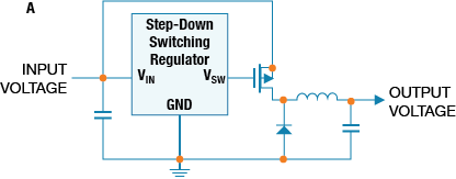

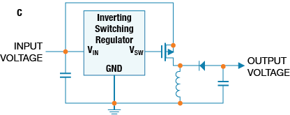

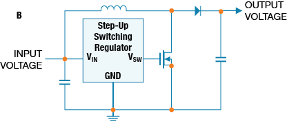

Switching Regulators
Switching regulators are so named because they switch a power transistor, which, when used in conjunction with an inductor, efficiently converts one voltage to another. When these power transistors switch, they do so very quickly, as fast transitions improve the regulator's efficiency. To understand why, first consider the power transistor's power dissipation when it is not transitioning. When the transistor is off, voltage appears across it, but no current flows through it. So, no power is lost. When the transistor is on, a small voltage appears across it while appreciable current may flow through it. Thus, typically, a small amount of power is lost. When the power transistor transitions from an OFF state to an ON state, or vice versa, voltage appears across the transistor while current flows through it. Therefore, appreciable power can be lost. Speeding up the switching process reduces these transition losses.To minimize the power loss associated with the rectifier diode in a switching power supply, a synchronous configuration can be used. In a synchronous configuration, the rectifier diode is replaced with a MOSFET switch. This approach increases the efficiency of the switching converters even further.
Figure 2: Switching Regulators: (a) Step Down, (b) Step-Up, and (c) Inverting
Switching regulators are popular because they possess excellent efficiency when subjected to different combinations of input voltage and load current. The levels can be as high as 96% for both step-up and step-down switchers, although a step-down is typically more efficient, and up to 90% for an inverter. Also, if you need to step up, step down, or invert a voltage, switching regulators are the only devices capable of these operations for load currents above approximately 125mA.

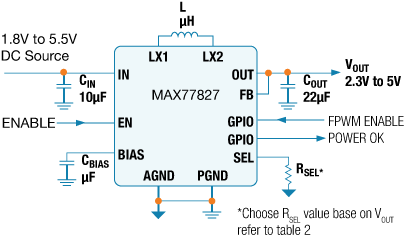

High Efficiency Buck-Boost Converter for Battery-Powered IoT Applications
The growing lithium-ion battery market is largely driven by an increasing inclination towards smart electronic devices with expanding functionalities. Primary cell batteries based on Lithium Thionyl Chloride (Li-SOCl2) chemistry or dual-cell Alkaline (AA or AAA) with operations as low as 1.8V is also gaining popularity in portable devices. No matter what type of battery is employed, these devices will discharge through a wide range of voltages while sustaining a power rail between 2.8V to 3.8V, specifically for powering MCU, Wi-Fi, BLE and GPS features.
The traditional buck or bypass boost plus low dropout (LDO) topologies are not ideal solutions for these smart devices because they are not the most efficient at extending battery life. This A better solution is a buck-boost convert such as the MAX77827 that can maximize battery life and address the power requirements of many internet of things (IoT) applications.
The MAX77827 has a quiescent current of 6µA and a peak efficiency of 96%, allowing it to support low-power requirements because, regardless of the battery voltage variations, it can automatically transition between buck and boost modes to provide a consistent output power supply. The IC buck-boost regulator utilizes a four-switch H-bridge configuration to realize buck and boost operating modes. This topology maintains output voltage regulation when the input voltage is greater than, equal to, or less than the output voltage. The buck-boost is ideal in one-cell Li-ion battery powered applications and two-cell Alkaline battery powered applications, providing 2.3V to 5.3V of output voltage range. High-switching frequency and a unique control algorithm allow for a very small small solution size, low output noise, and a very high efficiency across a wide input voltage and output current range.
Figure 3: MAX77827: Low-quiescent-current, buck-boost converter with a peak efficiency of 96%

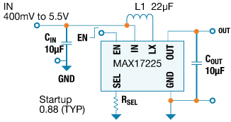

Synchronous Boost Converter for a Wearable Heart Monitoring Patch
Internet of Things solutions often require small devices operating autonomously for long periods of time while consuming little power. A good example of this type of IoT device would be a wearable heart monitoring patch. Such a device, powered by a 100mAh alkaline button cell and consuming 100µA in operation, can last 3 weeks. In shutdown mode, the device may need to last up to 3 years, which requires a leakage current of 4µA or less. A typical voltage regulator, with a leakage current of 0.2µA and a total quiescent current of 10µA will subtract 1.8 months from the device’s shelf life and two days of operation. To extend the battery life for this situation, a designer should consider the MAX17225 nanoPower synchronous boost converter. Here's why.
The MAX17225 has a 400mV to 5.5V input range, 1A peak inductor current limit, 95% Peak Efficiency, 300nA Quiescent Supply Current, and an output voltage that is selectable using a single standard 1% resistor. It has a True ShutdownTm mode that yields leakage currents in the nanoampere range, making this a truly nanoPower device. The True Shutdown feature disconnects the output from the input with no forward or reverse current, resulting in very low leakage current. The MAX17225 also features low RDSON, on-board powertrain MOSFET transistors, to yield excellent efficiency even when operating at frequencies high enough to warrant a small overall PCB size. The MAX17225, ultra-low quiescent current, high-efficiency synchronous buck converter significantly increases the shelf and operation life of IoT devices.
Figure 4: MAX17225: Typical Operating Circuit

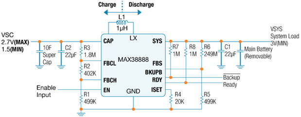

Storage Capacitor Bank Backup-Regulator for Mission-Critical Applications
Mission-critical conditions require regulated power even with the main power source is deenergized.  Thus, high-performance regulators charge a backup power source, such as a super-capacitor or capacitor bank, in just seconds to deliver continuous power to critical system components when the main power source is turned off. This solution is personified by Maxim’s ContinuaTm family of backup power regulators. Let's look at how they work, examiningg the MAX38888.
The MAX38888 is a storage capacitor or capacitor bank backup regulator designed to efficiently transfer power between a storage element and a system supply rail in reversible buck and boost operations using the same inductor. When the main supply is present and above the minimum system supply voltage, the regulator operates in buck mode and charges the storage element at up to 500mA peak inductor current. Once the storage element is charged, the circuit draws only 2.5μA of current while it maintains the super capacitor or other storage element in its ready state. When the main supply is removed, the regulator operates in boost mode and prevents the system from dropping below the minimum operating voltage, discharging the storage element at up to 2.5A peak inductor current. The MAX38888 is externally programmable for minimum and maximum voltage of the storage element, such as super capacitor, minimum system voltage, and maximum charge and discharge currents. The internal DC/DC converter requires only a 1μH inductor.
The MAX38888 reversible buck/boost regulator delivers has a 95 percent peak efficiency. Operating over 2.5 to 5V input in buck mode, the MAX38888 charges an energy storage device at up to 500mA peak inductor current. On supply failure, MAX38888 operates in a boost mode, providing 2.5 to 5V output at up to 2.5A peak inductor current from an energy storage device, discharging all the way to 0.8V. In portable electronics where the main power source is a battery, the MAX38888 doubles battery life by lowering quiescent current up to 15 times lower than competitive solutions during idle mode.
Figure 5: MAX38888: Typical Operating Circuit
