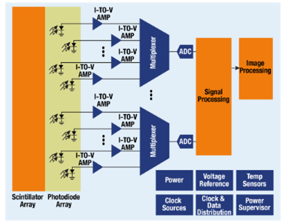

Proper temperature is critical to electronic system operation and must satisfy particular specifications. Since Tomography scanners generate significant heat during the use of coils and focusing electrons, the risk of overheating and damage of internal components is notably increased. This may also influence the acquired data by the addition of further noise. Also, the tomography exam room operating temperature should be kept as close to 72° F as possible (never to exceed 75° F or fall below 64° F).
Temperature sensors are a mandatory component of image scanning devices, as shown in Figure 1. The temperature monitoring system senses changes in the instrumental environment and immediately transmits a signal to the system brain (microcontroller/processor) for corrective measures or to alarm the system. Medical imaging instruments are expensive pieces of equipment, requiring proper system monitoring and maintenance. Physical sensors, like temperature sensors in the instruments, safeguard the system from further damage and increase the instrument's life span.
Figure 1.Sample Block diagram of a CT imaging system.
