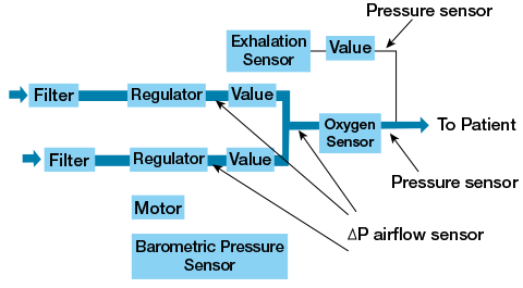

Differential pressure sensors or transducers measure flows in several devices. The airflow is proportional to the pressure drop across a curtailment in the flow path. The transducer measures pressure difference, and a signal is sent to the ventilator display. The ventilator controller's feedback loop permits the sensor to maintain and monitor a desired set of conditions. Ventilator design can vary, but all of them have common areas where pressure sensors are used.  These are explained in the following diagram:
Figure 1: Typical components and potential locations for pressure sensor/transducers in a ventilator
1. Pressure measurement between filter and regulator from initial air and oxygen inputs.
2. An oxygen sensor first measures the air/oxygen mix, and then a pressure sensor measures the inhalation (or pressure applied to the patient). A few ventilators may measure the gas pressure leading to the attached external humidifier.
3. Pressure measurement is taken from the patient when that individual exhales (breathes back) into the ventilator.
4. The ventilator's physical location determines the barometric pressure measurement obtained to offset any elevation changes.
The accuracy of such a measuring technique hinges on a combination of the pressure sensor and the component employed to extract the pressure drop, usually a linear flow element or an orifice. These pressure sensors must have high measurement accuracy and short response time. The sensors must also be rugged and have durable stability to minimize maintenance and re-calibration.
