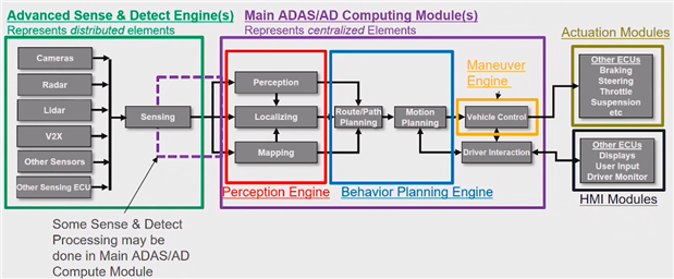

Autonomous Driving needs: Scalability, Modularity, Portability, and Adaptability
Xilinx FPGAs' integrated connectivity and programmable architecture are optimal for automotive applications. Since the hardware is standard across multiple car models, the connectivity can be added or updated as network standards evolve. Xilinx products satisfy the dynamic application needs of various vehicle platforms in a scalable, cost-effective, and timely manner. Such increased system performance, combined with highly integrated architecture, reduces the overall power and bill of materials (BOM) cost of Xilinx All-Programmable SoCs. It imports flexibility with programmable interfacing choices for different standards.
The solution must be scalable in BOM costs adjustment in a wide range of systems, from simple to complex ones. This is vital, as its scalability makes it possible to re-program and add processing power to scale their systems needs to satisfy rising complexity, capabilities, or speed. The architecture facilitates programmable fabrics addition when the application demands it.
Portability is a must for design migration between generations of the device family over time. Algorithms and interfaces should be efficiently adopted across several product life cycles, calibrating to new sensing technologies. The modern automotive industry imposes new restrictions on automakers, championing greater efficiency, and highlights the need for adaptable processing engines. This is why modularity (the ability to adjust discrete processing performance elements) brings partitioning and functional safety advantages.
The ASICs and GPUs are essentially one-size-fits-all solutions. Automakers can take advantage of the FPGA's programmable nature and customize chips to run proprietary algorithms.
Click image to enlarge
Figure 1: Automated driving systems functional diagram (Image credit: Xilinx)
The primary aim of ADAS technology is to make drivers better aware of their environment for a safer drive. The technology assures a stress-free driving experience. Modern high-end automobiles incorporate ADAS products fitted with advanced rear-camera and fusion-sensor systems.  The sensors simultaneously perform multiple tasks, like lane departure, blind spot monitoring and warning, automated cruise control, pedestrian and sign detection, drowsy-driver detection, and forward-collision warning.
Many vehicles have adaptive cruise control, collision avoidance, intelligent speed control, automated parking, and lane-keep assist. These revolutionary technologies represent baby steps in the automotive industry’s efforts to offer consumers fully autonomous and self-driving vehicles where the driver is, for all intents and purposes, a copilot.
