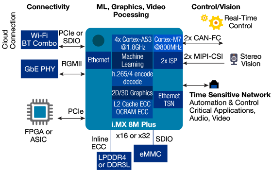

An excellent example of the possibilities is the NXP i.MX 8M Plus heterogeneous application processor, with an integrated machine learning accelerator that can process neural networks about thirty times faster than ArmRegistered processor cores. It provides dedicated machine learning (ML) hardware, in the form of a neural processing unit (NPU) from VeriSilicon (the Vivante VIP8000). Developers can off-load machine learning inference functions to the NPU, allowing the high-performance Cortex-A53 and Cortex-M7 cores, DSP and GPU, to execute other system-level or user applications tasks, as shown in Figure 2.

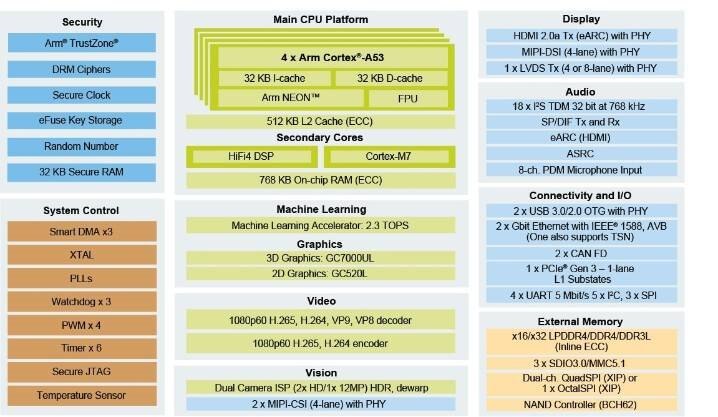

Figure 2: Block Diagram of i.MX 8M plus Application Processor
So now, given the need for ML in the edge, the question is its extent. One way to measure ML accelerators is the number of tera operations per second, usually referred to as TOPS, an acronym for Tera (trillion) Operations Per Second. It turns out that i.MX 8M Plus offers 2.3 TOPS of acceleration for inference in endpoint devices in the consumer and industrial internet of things, adequate for applications like multiple object identification, speech recognition up to 40,000 words, or even medical imaging (MobileNet v1 at 500 images per second). It can execute various intricate neural networks simultaneously.
The NPU, combined with the i.MX 8M Plus dual image signal processors (ISPs) and GPU, enable real-time image processing applications. To make this a complete solution, NXP has given it eyes and ears by adding two camera ISP inputs of 12 Megapixel with high dynamic range (HDR), fisheye lens correction support, and eight microphone inputs. The ISP integrated within the applications processor offers high-quality imaging, while also being an optimized imaging solution, particularly at 2 Megapixel and higher resolutions. It incorporates an independent 800 MHz Arm Cortex-M7 for real-time tasks and low-power support, video encode and decode of H.265 and H.264, and 800 MHz HiFi4 DSP and 8 PDM microphone inputs for voice recognition. Industrial IoT features include Gigabit Ethernet with time-sensitive networking (TSN), two CAN FD interfaces, and ECC.
The i.MX 8M family application processors support high definition of audio and video capabilities, high-performance 3D graphics acceleration, dual camera inputs proving best in class multimedia performance with multiple high-speed interfaces. The architecture was until now restricted to dual-core power-optimized Cortex A-53, Cortex M4 processors that enabled concurrent execution of various software environments. All previous i.MX8 chips use their Cortex-A53s for local AI inference, and four of those general-purpose CPUs can manage only 0.03 TOPS.  In comparison to its legacy family versions, the i.MX 8M plus application processor with its ML accelerator capabilities is the unrivaled fit for AI edge applications.
