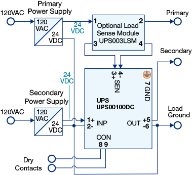

The Panduit UPS00100DC Industrial Network Uninterruptible Power Supply (UPS) uses ultracapacitor technology. It is designed to provide backup power to a 24 VDC load in the event of a power dip or outage. The unit utilizes Electrochemical Double-Layer Capacitor cells as the energy storage device to provide a long, maintenance-free operating life sans battery replacement. The UPS accepts a 24 VDC input voltage, and offers 24 VDC output voltage to a load with a maximum output power of 100W. A bank of twelve 350F EDLCs provide energy storage of approximately 9.3 kJ, which can supply a 100W load for a run time of about 1 minute.
The UPS is intended to provide uninterrupted power for critical applications, including managed network switches, micro PLCs, and HMIs deployed on the factory floor. The device is suitable for use in extremely low-temperature environments and elevated temperatures of -40 to +60°C, without loss of performance or reduced life.
Figure 4a. Panduit UPS00100DC System Wiring Diagram
Figure 4b. Panduit Ultracapacitor UPS Panduit Ultracapacitor UPS
Panduit's UPS00100DC UPS can be used in a redundant power supply system or a single supply system. In a redundant power supply system, the UPS monitors the power delivered by a second supply to the load through an external load sense module (LSM) UPS003LSM. Another configuration has the UPS providing backup power to a load with a single power source. To visualize this configuration, remove the Primary Power Supply, the LSM, and the associated wiring in Figure 4a.
