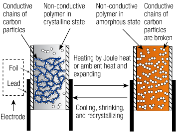

PTCs – Basic Theory of Operation
Since PTCs are thermistors, the excess current flowing through a device can cause it to heat up, increasing the PTC's temperature. This temperature rise causes an exponential resistance increase in the PTC, thus restricting current flow across it. The PTC is a block of polymeric material with conductive carbon granules sandwiched between two highly conductive metal plates. Volumetric swell happens when such a polymer block touches about 125℃, either due to electricity flow via carbon particles made conductive chains, or due to any external heat source. Such an expansion splits a majority of the carbon granules chains that run randomly in-between these two conductive plates.
A PTC, during regular operation, only adds a minute quantity of resistance in series with the circuit.  Any over-current condition quickly trips a PTC into its high-resistance state.
Figure 1: The internal structure of a polymer PTC and thermal expansion model (Source: Failure Causes of a Polymer Resettable Circuit Protection Device, Journal of Electronic Materials)

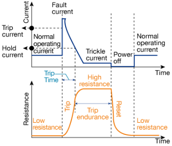

Figure 2:  Operational process of PTC resettable fuse (Source: Failure Causes of a Polymer Resettable Circuit Protection Device, Journal of Electronic Materials)
A PTC resettable fuse "trips" from its normal low resistance operational state to high resistance within a short time when overheated by the high current generated ambient heat or Joule heat. It resets to its normal low resistance operating state when its power gets switched off, or heat is removed. Fig. 2 illustrates its operational process. The fuse, under usual ambient temperatures, works in a low-resistance state during the passage of standard current. However, the fuse resistance shows a sharp increase during a fault current. The PTC fuse, due to the resistance spike, will protect the circuit by reducing the current. A trip is a sharp resistance increase. After the trip, the PTC resettable fuse is unbroken, unlike a traditional fuse. The PTC maintains its high-resistance state, permitting a small trickle current to course through the circuit. The fuse will reset to its low-resistance state after a short interval, when the fault current or heat is removed, and the power switched off. Such resettability shields electronic equipment, all of which remain entirely functional.
The hold current typically is half the trip current. The fuse trips when the hold current exceeds the trip current. When the current lies in-between the trip and the hold current, the fuse may trip or may not. Trip time is the time a PTC fuse needs to decrease the circuit current to hold at ambient temperature. A PTC resettable fuse degrades after a few trip-reset cycles. '
