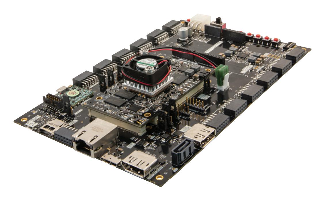

CoM: Computer-on-Module
A CoM (Computer-on-Module) is a step above an SoC, and is placed between a full-on computer and a microcontroller when it comes to performance and functionality. By definition, CoMs are complete embedded computers built on a single PCB, which are similar to SoCs and SBCs in that they host a microprocessor, RAM, and I/O controllers, but they rely on a carrier board for all other input/output peripherals to be connected. This provides CoMs with an advantage over the others in this list, in that the carrier board can be upgraded with the latest CoM (Figure 3) when Ultrazed starter kitthey become available.
Another advantage of using a carrier board is that they can also be outfitted with FPGAs, which can port functions to the CoM or carrier board for increased performance. Being able to upgrade the processor without needing to redesign the carrier board can save costs, development times, and the ability to develop both hardware and software simultaneously. The modular aspect of CoM design is also useful for manufacturers making a line of scaled products, providing the ability to swap out some parts of the system, enabling different levels of functionality between an entry-level product and a feature-packed high-end model. Each level of the product could also have its own set of peripherals that could be swapped out as new upgrades become available, making them cost-effective in both the short and long term.
Figure 3: Computer-on-Module ( UltraZed Starter KitUltraZed Starter Kit )
The differences between SoCs, SiPs, and CoMs are minimal, and yet each has its advantages and disadvantages over the others, which boils down to functionality and application types. While SiPs and SoCs can be used for compact and embedded solutions, such as smartphones and wearables, CoMs have an upgrade path and can be utilized as full-blown computers to some extent.
