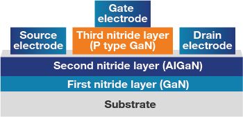

GaN transistors have significant advantages over silicon MOSFETs in terms of switching speed and power conversion efficiency. GaN is a high electron mobility transistor (HEMT), as shown in Figure 1. The high electron mobility means that a GaN transistor will have a smaller size for a given on-resistance and breakdown voltage than a silicon transistor. GaN transistors can operate at higher temperatures and higher current densities than their Si counterparts. Such properties make GaN transistors well-suited for high power, high frequency and wide bandwidth applications in extreme environments, as listed in the application section. Since the individual transistors are smaller than their silicon counterparts, many more GaN transistors can be produced per wafer, thus forming a situation where GaN devices may have a competitive manufacturing advantage vis-à-vis their silicon cousins.
Figure 1. GaN HEMT Structure
Like a Silicon MOSFET, a GaN FET has a source, drain, and gate. GaN FETs operate speedily, with lower gate threshold voltages, and need customized gate drivers to satisfy requirements. The GaN FET’s internal-gate resistance is much lower and there is no reverse recovery charge, unlike silicon FETs. A Barrier semiconductor layer isolates the gate and the channel so that minimal current flows between the channel and the gate. In GaN FETs, the barrier is typically made of aluminum gallium nitride (AlGaN) or Indium aluminum nitride (InAlN).
The substrate is the last and thickest layer of the vertical structure. It provides mechanical support, heat spreading, and electromagnetic confinement. GaN FETs use a foreign substrate to avoid costly issues. The following list names a few widely used substrates:
