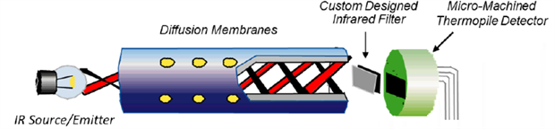

Carbon Dioxide (CO2) Sensor
A carbon dioxide sensor is a device used to calculate gaseous carbon dioxide levels. They are classified into two types: IR-based and electrochemical. CO2 is not very reactive and is impossible to detect using electrochemical cells. The IR sensors determine the quantity of gas by the amount of light the gas absorbs, rather than by a chemical reaction. Gases absorb specific light wavelengths, and particular gases absorb specific frequencies. The light emitted by a special "source" proceeds via a filter that screens out everything except an individual light wavelength set, typically inside the spectrum's infrared part. Figure 2 illustrates a CO2 sensor based on IR.
Figure 2: CO2 sensor structure and inner workings (Source: Amphenol)
The following steps describe its operation:
• Carbon dioxide gas molecules absorb infrared light per the Beer-Lambert law. Non-Dispersive Infrared (NDIR) sensor modules apply this principle.
• An infrared source emits energy via a gas sample cell (waveguide). A tuned optical filter eliminates all but the target wavelength for the gas of interest (~4.3 µm for CO2) from interaction with the thermopile detector. The thermopile then changes the amount of filtered infrared energy to an electrical signal—the greater the gas concentration (CO2), the lower the infrared energy that reaches the detector.
• A microprocessor appraises the detector's electrical signal with sensor calibration constants and other parameters, offering a signal-conditioned gas concentration output (ppmv).

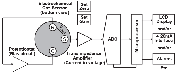

Circuit with SGX-4CO Industrial Carbon Monoxide (CO) Sensor
The SGX-4CO is an electrochemical-type CO gas sensor with three electrodes, as shown in figure 5. It provides an output current of 70 ± 20nA / ppm corresponding to the gas concentration exceeding the  0 – 2000 ppm range.  As this is an electrochemical gas sensor, it needs a potentiostat (a bias circuit) to continue the accurate bias potential among the reference and sensing electrodes. A trans-impedance amplifier, also known as a current-to-voltage converter, is needed to change the small electrochemical currents into a useful voltage, which can then be measured.
The analog-to-digital converter (ADC) samples the trans-impedance amplifier's output and produces a digital reading of the voltage level. The microprocessor uses this to calculate the actual gas concentration. The microprocessor may drive several outputs, depending on applications. These could include an LCD, a 4 – 20 mA interface, many alarms, or other outputs as needed. Figure 5 shows a block diagram of a typical gas detection system using an electrochemical gas sensor. At some point in the system, zero settings and repeated setting adjustments are required. This can be implemented in the hardware at the trans-impedance amplifier, or in software within the microprocessor.
Figure 5: Typical Gas Detection System with CO gas sensor (Source: SGX Sensortech/Amphenol)

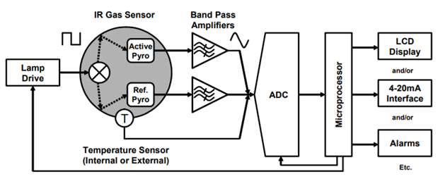

Circuit with IR11 Series Infrared Carbon Dioxide (CO2) Sensor
The SGX IR11 series is a CO2 sensor established on the Non-Dispersive Infrared (NDIR) principle to detect and track gases' existence. It provides a voltage output and works with a 3v - 5v DC power supply. These sensors are appropriate for reliable gas levels in general safety applications, where the sensor size is constrained and needs a flameproof enclosure for hazardous environments. These sensors are interfaced to a suitable circuit for power supply, output amplification, and signal processing. Sensor outputs require linearization and compensation for ambient temperature variation using algorithms in the system firmware. Figure 6 shows a block diagram of a typical gas detection system using an infrared gas sensor:
Figure 6: Gas Detection System with IR based CO2 gas sensor (Source: SGX Sensortech/Amphenol)
The IR gas sensor accommodates a lamp pulsed at low frequency by a lamp drive circuit. Pyroelectric detectors (pyros) are used to detect any infrared signal variations. The active pyro is sensitive to changes at IR wavelengths, typically absorbed by the traced gas. The reference pyro is sensitive to changes at a nearby IR wavelength, which is not absorbed by the gas being detected. The output signals are roughly sawtooth-shaped and amplified, and filtered. A bandpass amplifier is used to pass only the fundamental frequency and reduce any pyro noise at other frequencies. The amplifier outputs are approximately sinusoidal in shape.
The ADC samples the maximum and minimum of the amplifier outputs to ascertain the peak-to-peak level, and then a microprocessor is employed to calculate the actual gas concentration. The microprocessor may drive some outputs depending on the application, including an LCD, a 4 – 20 mA interface, multiple alarms, or other outputs as required.
