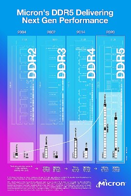

DDR DRAM first arrived on the scene as a high-performance, low-cost memory solution targeted primarily at the personal computer and other cost-sensitive consumer markets. DDR has become globally popular over the last few decades, due to its low latency, low cost, and straightforward architecture. It has been used extensively in notebooks, laptops, gaming devices, and embedded computing systems. DDR DRAM memories are widely used in high-speed, memory-demanding applications, such as graphic cards, where there is a requirement to synthesize large amounts of information quickly. Servers, or single-purpose boards, powered by a single, more efficient power supply also need fast memory access, which DDR memories can accomplish. LPDRAM (Low-power DRAM) is specially used in consoles and many other mobile/portable devices due to its small size, low-power consumption, and cost-effectiveness.
The DDR series available in the market is characterized by each DDR manifesting new features and increased memory density. DDR1 SDRAM was succeeded by DDR2, DDR3, DDR4, and most recently, DDR5 SDRAM. Although they operate on identical principles, the modules in these generations are not backwards-compatible. Each generation delivers higher transfer rates and faster performance. Let's have a look at the types of DDR memories available across a generation.
DDR RAM Evolution
Figure 1. Generation of DDR memory
(Source: Micron)
First generation – DDR SDRAM
DDR SDRAM prefetch buffer size is 2n (two data words per memory access), double SDR SDRAM's prefetch buffer size. Prefetch, by way of review, allows a single address request to result in multiple data words. The internal clock speed of 133 ~ 200MHz gave the transfer rate of DDR1 as 266 to 400 MT/s (Million transfer per second). The DDR1 ICs were commercially released in 1998.
Second-generation – DDR2 SDRAM
DDR2 operates with an external data bus twice as fast as DDR1 SDRAM. The improved bus signal is responsible for such an achievement. The prefetch buffer of DDR2 is 4-bit, which is double that of DDR SDRAM. DDR2 memory has the same internal clock speed (133 ~ 200 MHz) as DDR memory. However, DDR2 memory has an improved transfer rate (533 ~ 800 MT/s) and I/O bus signal. DDR2-533 and DDR2-800 memory types were commercially released in 2003.
Third-generation – DDR3 SDRAM
DDR3 operates at the double the speed of DDR2. Further improvements in the bus signal allow such achievements. DDR3's prefetch buffer width is 8-bit, which is double that of DDR2. The transfer rate of DDR3 is 800 ~ 1600 MT/s. DDR3 operates at a low voltage of 1.5V compared with DDR2's 1.8V, which results in 40% less power consumption. The DDR3 ICs were commercially released in 2007.
Fourth-generation – DDR4 SDRAM
DDR4 kept the prefetch buffer size the same as DDR3, but achieved even higher speed and efficiency by sending more read / write commands per second. DDR4 standard divides the DRAM banks into two or four selectable bank groups, where transfers to different bank groups can be done faster. The operating voltage of DDR4 is reduced to 1.2 V compared to DDR3.  The transfer rate of DDR4 is 2133 ~ 3200MT/s. DDR4 ICs were commercially released in 2014.
Fifth-generation – DDR5 SDRAM
DDR5 SDRAM, commercially released in 2020, achieves higher speed by using a 16n prefetch buffer. DDR5 supports memory density from 8 GB to 64 GB, combined with a wide range of data rates from 3200 MT/s to 6400 MT/s.  The operating voltage of DDR5 is further reduced from 1.2V of DDR4 to 1.1V, approximately 8% lower than DDR4.  This memory enables what contemporary data centers need: increased reliability, availability, and serviceability (RAS).

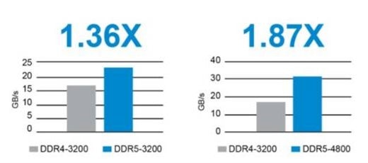

DDR5, the successor of DDR4, was developed to deliver performance improvements when system designers felt rising pressure from continuous technological advancements—the memory bandwidth being unable to keep pace with newer processor models with escalated core counts. While previous generations focused on reducing power consumption and were driven by mobile and server applications, DDR5's primary driver was the need for more bandwidth. Compared to DDR4 at an equivalent data rate of 3200 mega transfers per second (MT/s), a DDR5 system-level simulation example indicates an approximate performance increase of 1.36X effective bandwidth. The approximate performance of DDR5-4800, at a higher data rate, increases to 1.87X—nearly double the bandwidth as compared to DDR4-3200. Micron's DDR5, driven by data rates up to 6400 MT/s and key architectural improvements, pushes potential system bandwidth even higher.
Figure 2:  Effective Bandwidth Comparison: DDR4 vs. DDR5. (Source: Micron)
With DDR5 DIMMs, power management moves from the motherboard to the DIMM itself. The DDR5 DIMMs have their voltage regulators, and 12V power management integrated circuits (PMICs) allow better granularity of system power loading and assists with signal integrity and noise issues. The DDR5 architecture increases the value that Micron brings to the industry with DRAM solutions. Significant performance improvements, made possible in part by increasing bank groups, burst lengths, and same bank refresh, help meet the stringent requirements of next-generation systems and improve the total cost of ownership. The system RAS is improved with the DDR5 on-die error correction code and post-package repair enhancement. Finally, the implementation of memory management is simplified with the use of the new multipurpose command feature.
